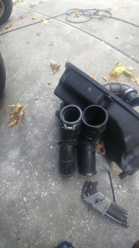

that hose is gonna be the same size. the other end of that hose connects to the throttle body. the throttle body is also the ecu. the connection is 55mm on the inside of hose, outside diameter of throttle body connection. . dont know outside diameter of the hose. I just used the hose on my yamaha majesty 400 project. the majesty has two airboxes. I wanted to eliminate one side. I used the gts250 hose as it was the right size to accomplish the task.
majesty on left, gts on right
