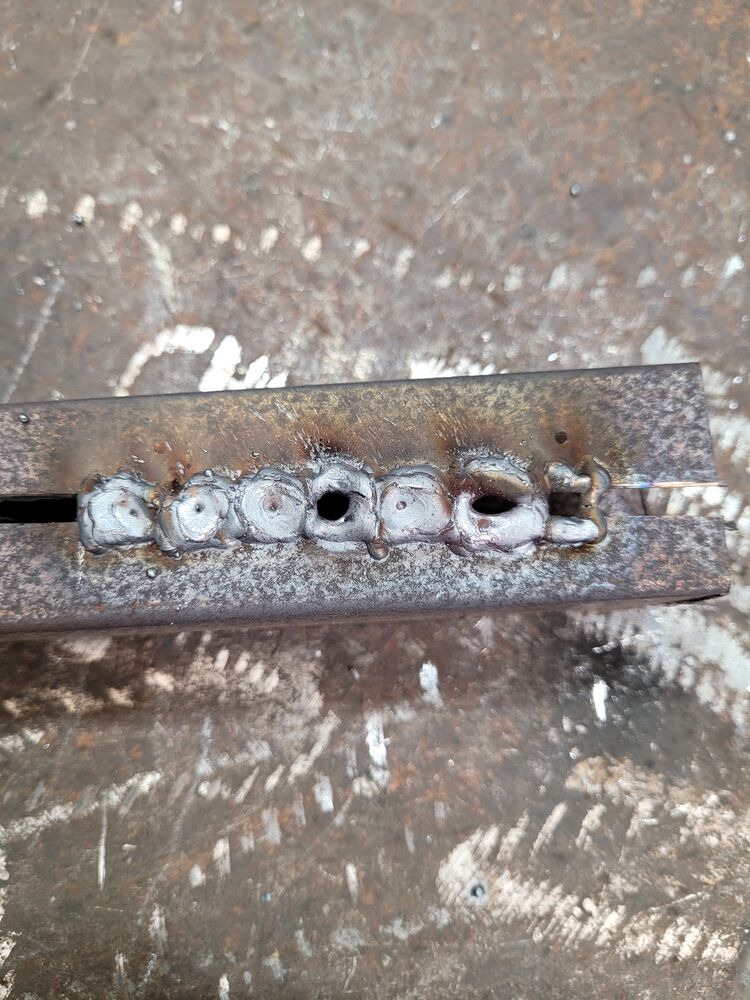

@ray8 avatar
Posts: 2076
@ray8 avatar
Posts: 2076
skids wrote:
The instant it begins to look like it's not going absolutely perfect STOP.
Yeah, if you can't get your initial tacks to look like the one circled in red (below), just walk away.
To demonstrate how quickly things can go bad, I went at my repair panel sample with the same settings:
@orwell84 avatar
Posts: 3736
Location: northern New York
@orwell84 avatar
Posts: 3736
Walking away is a great idea. It's when I get frustrated and keep pushing that everything goes to shit. A mistake on a little panel starts looking as big as a barn door. When you come back again, it looks normal again.
