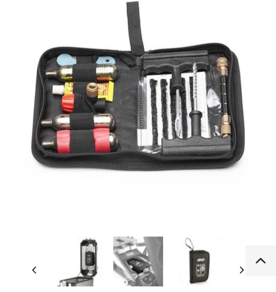

Buy the Givi tire repair kit, it works.

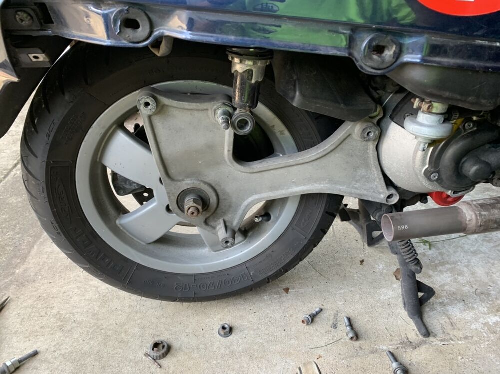

I wish!
Now I have to take off the exhaust, exhaust bracket and wheel.
Then put the new one on with the exhaust stuff to follow.
It might take an hour.
In the hot, Florida climate.
Oh well,
Bill
Luckily I could ride home on the deflating tire.
The holes on both tires are in the the bottom of big sipes.
Not much depth to hold the sticky string.
So the patch would be temporary at best.
But might allow me to get home, or to a shop (that probably wouldn’t have a replacement)
Bill

Because I had a mounted tire on the shelf, I went ahead and changed it out.
I always prefer a new tire.
I also have another mounted rear tire. It was punctured last year with only 1000 miles on it. I had it plugged from inside.
I checked it and it only had 5 lbs of pressure. I put soapy water on the plugged spot and saw tiny bubbles.
I put 40 lbs in it and will check it over the next week.
Might replace it with an Angel I will be getting soon.
Bill
