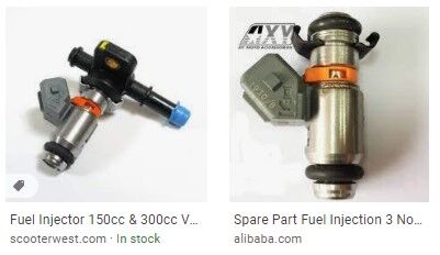

I was about to do a deeper dive into sorting out my problem, I pulled out the pet carrier and looked around a bit. What I must have missed yesterday was a crack on/near the fuel injector. ( I'm not too adept with this part of the scooter).
Anyway, I'm hoping this is my problem. Guess getting this sorted is my starting point.
Nora's MP3 250 had the electrical connector break off the fuel injector.
Looks like you have the same situation.
New injector for you!
Careful when you order the new one; they come in "with" or "without" return.
Looks like you need "without", so just one side with fuel connection, other side blocked.

Thanks, Robert. Looks like 6-8 weeks from AF1 though. SIP has the same price....higher shipping, for sure, but they've got nice bling.....
Look about right?
https://www.sip-scootershop.com/en/search/8732885
@madison_sully avatar
Posts: 7705
Location: Madison, Wisconsin
Posts: 7705
Look about right?
Looks right.
It's the same part number I put in, and about the same price.

Depending on how much you want to wait around for parts during peak riding season, and spending money, you might want to note that you can have the injector and electrical connection, not the plastic fuel line portion assuming that’s intact, for $16 by Tuesday if you search for “IWP182” on Amazon (Prime).
https://www.amazon.com/EPSIRMP-Injectors-Compatible-Piaggio-PI8732885/dp/B08TTGKJZ2

Umm, that price seems a bit dodgy. Besides, it doesn't seem to be the complete unit, at least to me.

As you wish, but for $16 there isn’t exactly a lot of risk and it looks as though you’d have weeks to test drive the cheap part. If you look at the part in your scoot there’s a plastic component that attaches to the pressurized fuel line, and into that fits the injector with the wiring plug that attaches to the ECU. The combination of the two are what cost >$100, but they are absolutely distinct components.
...and it looks like the plastic component is what faled...

The damaged little grey plastic part you're pointing to is the ECU electrical connector, and is part of the injector. The larger black plastic part is the other of the two components which are part of the expensive Piaggio assembly. That rather simple part is just the junction between the fuel line and the injector. It appears fine, and is held in place by the hex bolt near the left edge of the photo.
The injector part is retained in the black plastic part by that metal clip just above the orange disc in your photo, and is sealed in there with an O-ring. The injector is sealed in the throttle body with friction from another O-ring, and the two parts are held securely in place by the hex bolt.
Remove the hex bolt, tug out the injector, pull off the metal clip, and the injector separates from the black plastic part, which remains attached to the fuel line. Reassemble with new injector, reconnect the electrical plug to the grey socket, retighten the hex bolt - and you're back on the road by Wednesday for $17, assuming that was the problem. (Regardless, the broken grey plastic connector IS a problem.)
These photos of the eBay injector I bought for my 460cc engine might help clarify. Its electrical connector is black instead of grey. I'm guessing this one spritzes out a little more fuel mist than yours - perhaps the electrical connector color is how one distinguishes between the two.
https://www.ebay.com/itm/233187384037
The Piaggio exploded parts diagram for my 460cc makes no distinction between the two components of this injector assembly. This definitely helps obscure the fact that the injectors can be sourced independently of Piaggio.

If you trust the website selling it, at least, you can see that there is a sort of security circlip that holds the fuel delivery line to the top of the injector. Since your electrical connection is the part that is broken you could perhaps just buy the lower metal bits, and install the plastic fuel delivery part on top.
Why doesn't Piaggio supply it in such cheap format you ask? What's in it for them, I ask back....
Caveat emptor and all that carpe diem stuff....
What would I do?? What I did; I bought the one from a well known scooter supply house, at some additional cost.
One of these is just missing the fuel delivery part.

Well, kind of water over the dsm at this point, but seeing the plastic bit is what's toast, it seemed like I need the assembly to get it. If my injector was toast, the individual part would be perfect. Nicht wahr?
It's the lighter plastic bit that is broken. The black tubes on top appear intact.
I guess put it this way; save your injector for the next time someone has a broken electrical connector, then propitiously post on the freecycle thread.... Laughing emoticon

Okay, epilogue.
Part was waiting for me after my scooting trip. Got to it tonight, not all that hard to figure out disassembly, put the new one together and tried the starter to check for fuel, and yep, spraying fuel! Mounted it and hit the starter again and no start. Then I remembered I'd disconnected the spark plug cap. Got that snapped back with the usual difficulty and it started up....I'd swear better than before.
After a closer inspection, I could see that Juan, you were right on it. I don't really regret taking the expensive route, just for security, I guess, and the uncertainty at the time. Next time maybe not. Anyway, I got a shiny new SIP tee to wear while working on it and a couple of spare mugs, so it wasn't without it's compensations....
