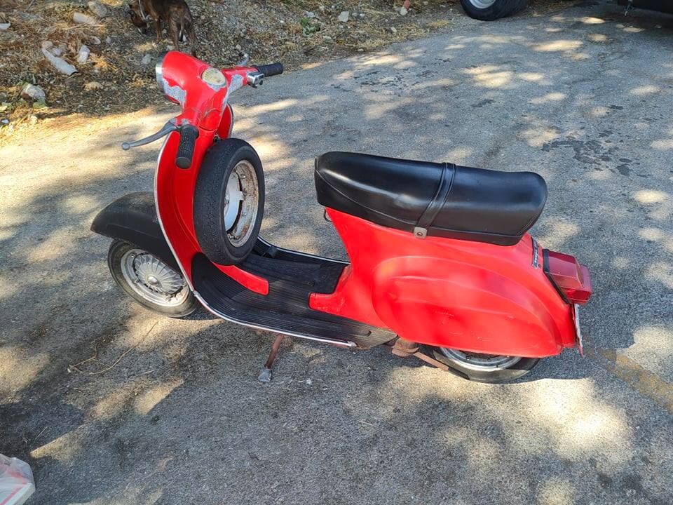

In the February i purchased a small frame. the frame is Vespa 50s and the rest of the scooter are primavera parts. including the engine. i purchased it thinking making a little powerfull small frame but the covid problem made me wanna sell it either wanna make a low badget restoration my own. i am just looking for ideas what i can do with the engine. want to be as powerfull, reliable and low badget possible. was thinking for dr130 and leave the 6v system as is.... also make a better clutch? crankshaft? or exhaust?
thanks in advance...
here are some pictures

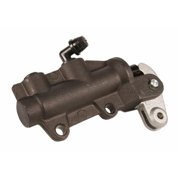

yesterdays quest and thoughts about the luck of the vespa.....
already have ideas and plans how to fit the fork and where to put the pump+reservoir
