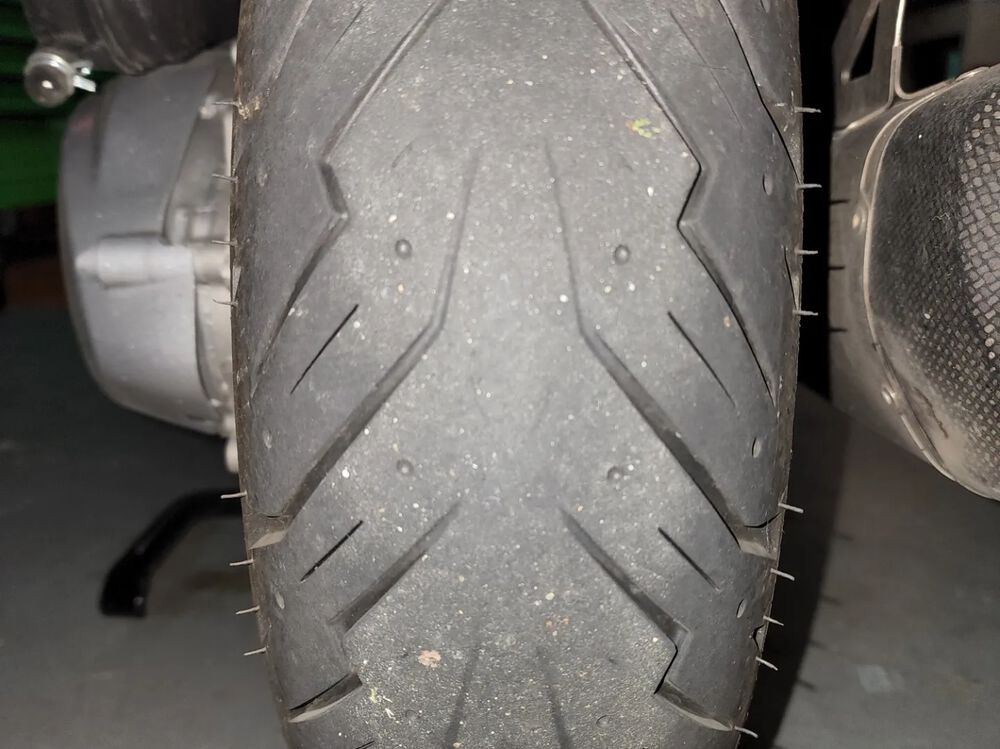

Results similar to wbdvt. We kept passing each other on the 2nd half.
BV250 with Malossi BBK. I was not shy about riding hard in the dirt or on potholed mountain goat roads. 70-75 MPH @ WOT. 325-350 lbs on board (rider + gear + tools + fluirds + parts).
32 psi rear, 29 psi front at sea level. Pressure was higher in the mountains. Never had to add air.
Pleasantly surprised at the traction and smoothness. Never got much of a wobble, even after they started squaring off. No slips in the rain or in the dirt, which was a surprise. I was probably a bit cautious and wasn't aware of it. Front seems to have gotten eaten up a little more, which was a bit of a surprise as I expected to burn through the rear much faster. Maybe I should have run a few psi higher?
These may be a budget alternative to the CG2's, but they certainly delivered for me.

Thanks for the report and your photos.

Performance wise, the Pirelli's are excellent, but this is what my rear tire looked like after just 4500 miles on a GTS300. It's worn thru the wear indicators and is effectively bald.

That tire has no wear on the side's, It must have been bolt upright for all 4500 miles Laughing emoticon

Or over-inflated?

Look again. The actual "chicken strips" are decently narrow at the edges of the tread.

It's definitely got wear on the sides and I generally keep it at 30psi 😁
The last 1100 miles were put on over this past weekend and I had a fair amount of weight on the back (25lbs.?). It looked like it had about 50% of the tread left when I departed. I inflated it 34 because of the load, but by the time I got to Florida (450+ miles) it was at the wear indicators.
