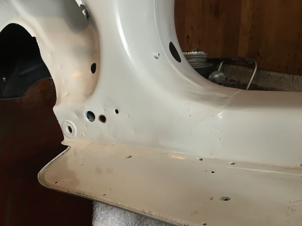

That thing is a mess. All the seams are hidden behind a ton of bondo.
Looks like an import bike. Why are people bidding so high on these?

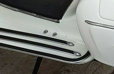

What's going on here?
Floor rails too small? Drill new holes.
lol - maybe the floor rails aren't too small, but the bike is too long from when they connected the two halves.
Not that they can be too small. They just aren't bent on the right angles wtf. So weird.

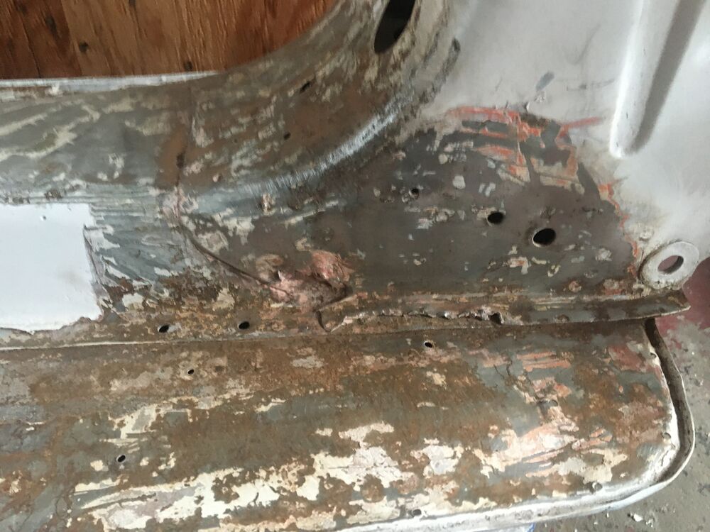

The bondo.
This is what was hiding under bondo like that on my current project.
