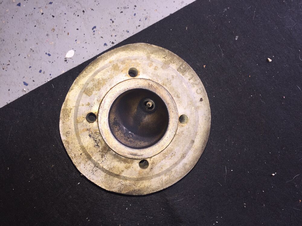

I'm looking at the burn pattern in the head and thinking the electrode is currently 180 degrees out of position.

What does the head of the piston look like?

Solid uniform carbon.

Maybe it's all academic, especially with a 5 hp engine, but if the electrode gap was facing inboard of the head, it would see the fuel-air mix faster and if nothing else would facilitate easier starting. Currently the gap on mine is in the shadow of the ground electrode as evidenced by the heavy carbon up the middle of the head. No?
