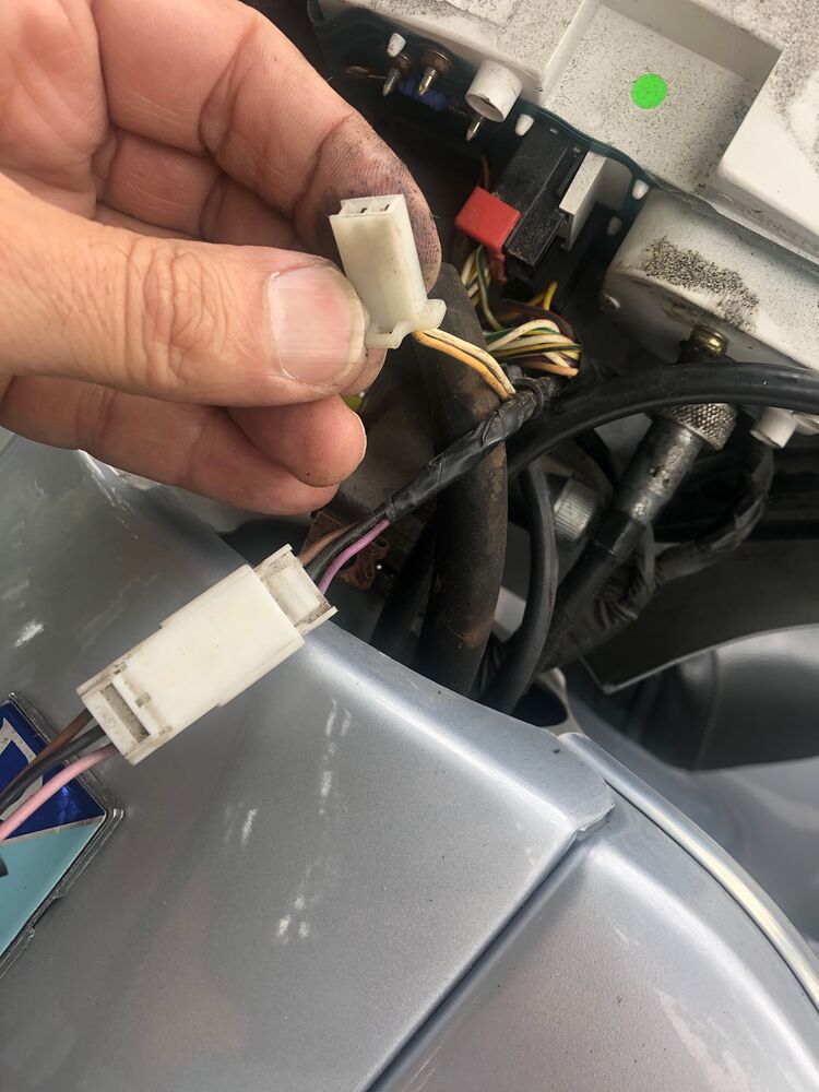

Speedometer and Odometer stopped working. I changed my headlight bulb recently and think speedo and Odometer may have stopped then..but not sure when they actually stopped.
I posted the cable...could it be the cut in cable that stopped both speed / odom?
I looked in side the headlight housing and found the Unattached connector, could that be the issue..if not what is that loose connector?

To my knowledge, that same "speedo" cable does in fact operate both the speedo and the odometer.
It's a mechanical cable that threads into the back of the dash - it's that knurled part in your second photo, and nothing to do with the unused electrical connector.
Almost certainly the broken sheath is also a broken cable inside, and causing your issues. Unfortunately, it's kind if a pain to replace!
I've had to do it twice on my LX. Pay attention to follow existing cable routing. I didn't, and I think I must have gotten the routing wrong and that's why mine don't last

Thanks for the info.. do you know what the loose wire is? Also, is it a pain to disconnect the cable at the wheel to check the gear that turns the speedo cable?

the inner cable probably broke. or possibly the drive pinion gave up the ghost.
doing the whole cable is a pain in all nine assholes, an inner isn't too bad, but I don't think anybody sells just an inner anymore and your outer looks like a whole bunch of butts. so, you can grab a complete cable (they're cheap) and just use the inner for now or tackle the whole job on a lazy Saturday.
however if it's just the pinion that's stripped? I'd yank it and slam a new one in there and roll. granted there's a whole bunch of preventive maintenance that should be TCB at the same time, but that can wait till later if you just wanna get rolling before riding season ends.
