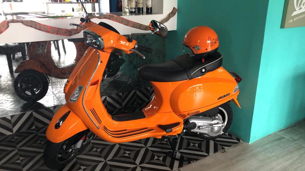

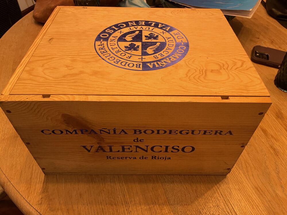

Hi everyone!!

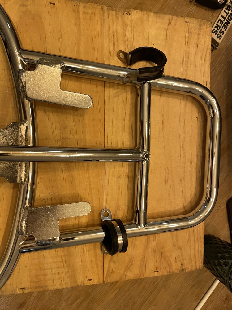

I am trying to figure out how to mount this wooden box to this rack. Any ideas would be appreciated since the rack only has one hole for a screw. Maybe those tube clamps?
I will be mounting it in an orange Vespa VXL (the ones made in india)
Thank you!
This is the box

The clamps should work fine. I would use 3 or 4 of them.

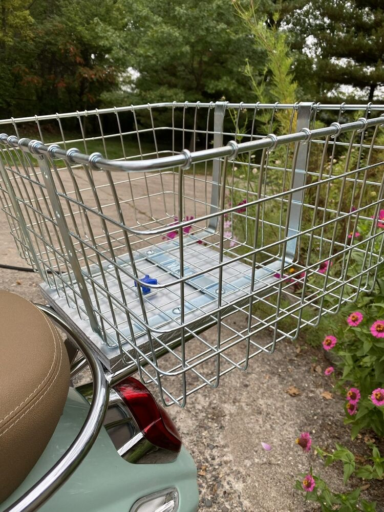

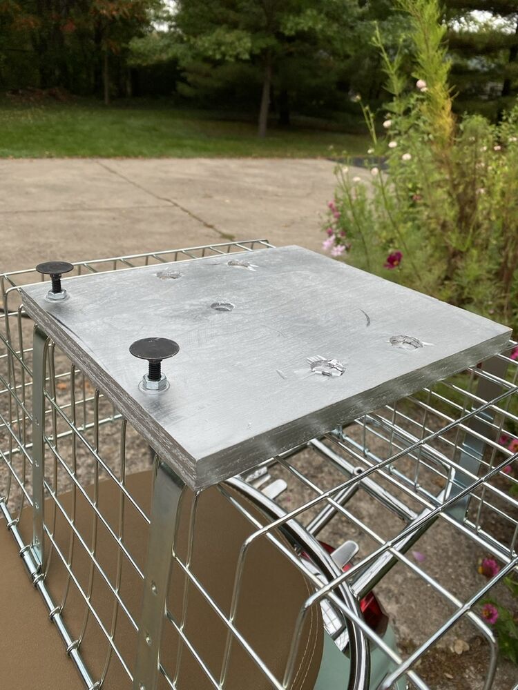

I wanted my basket to be easily removable so here's what I did. With your wine case, you could skip the piece of plywood I used. Everything I needed was at my local hardware store except the metric threaded long thumbscrew, which I finally found on Alibaba.

Didn't anyone notice that ValVitola selected clamps which already had integral rubber pads? (photo above)

It is not a coating, it is a rubber pad. Local hardware stores around here stock this clamp. Perhaps they are not available in some areas.

But ... The wood is in contact with the roof rack and the rubbing between two different materials damages the softer material. The rubberized clamps eliminate only the vibrations between the wooden crate and the iron roof rack.
