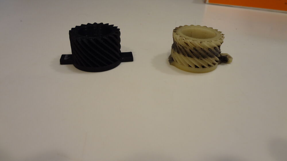

Nice but there is no Vespa logo.
Posts: 7864
Posts: 7864
If it is just a gear, it could easily be 3D printed. My son made a speedo gear for my DR350 that works between the front wheel hub and the worm gear that turns the cable for pennies.
