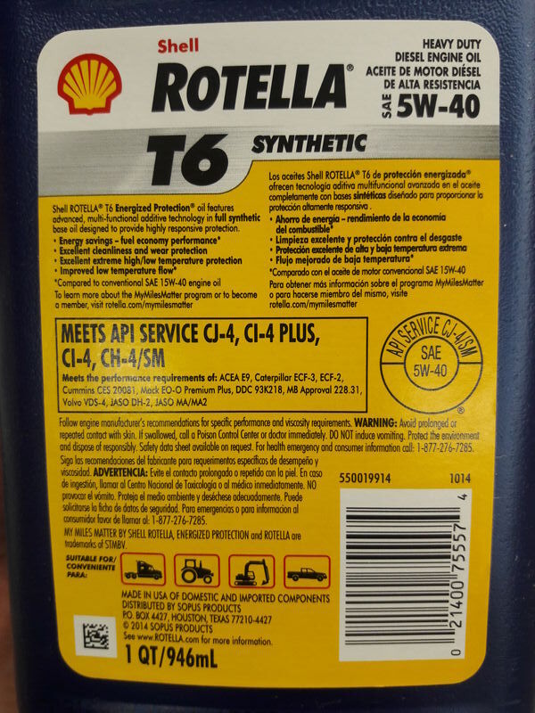

https://www.oildepot.ca/tag/shell-rotella/
Read the pic below. It says "meets performance requirements", that does not mean it is JASO cerfified. Here is the actual JASO list. Yes, Shell is on that list but Shell Rotella is not.
http://www.jalos.or.jp/onfile/pdf/4T_EV_LIST.pdf
And also be aware that our bikes are a world apart from say a Harley that uses a separate oil tank for the transmission and is essentially World War 2 engine technology.
"Meets performance requirements" is plenty for me. I mean, I want the oil to perform; that is what I want the oil to *DO*. Shiny boxes and marketing hype irritate me.
