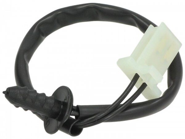

3. 'external'/'ambient' air temp. This is what's displayed on the top right of dash and is generally wrong enough to be essentially useless. This is the one that Robot said moved. The parts diagram for the 2019/2020 editions of the supertech show it in the lower right of the legshield. This sensor has nothing to do with the ecu or engine (else it would also be on a hpe gts not just supertech)

Curiously the diagram makes it look like the same shape as the sensor that would be screwed into an engine manifold. I wonder if that's what they have used, but just screwed somewhere on the frame in free air. We will see.

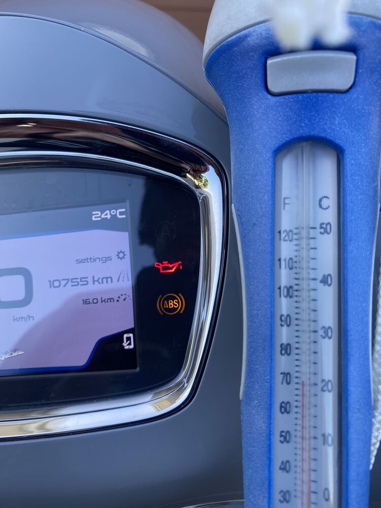

after riding a supertech for 2 & 1/2 years I suggest sticking a bit of tape over the ambient temp sensor display on the dashboard. It gets further and further above reality the long your ride as the whole front of the bike can get pretty warm

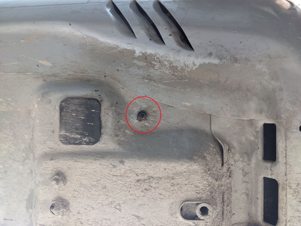

found it on my Australian* 2019 Supertech. I confirmed this by using a hair dryer then an ice pack to change the temp. note: the temp on the dash is pretty slow to respond, turning the ignition on/off helped my testing.
this is under the right floorboard, half way along. right near the tilt switch. and the return hose from the radiators back to the engine runs right above this so ...
* I mention Australia as a reminder that our bikes here come from the Vietnamese factory unlike the European and North American models.

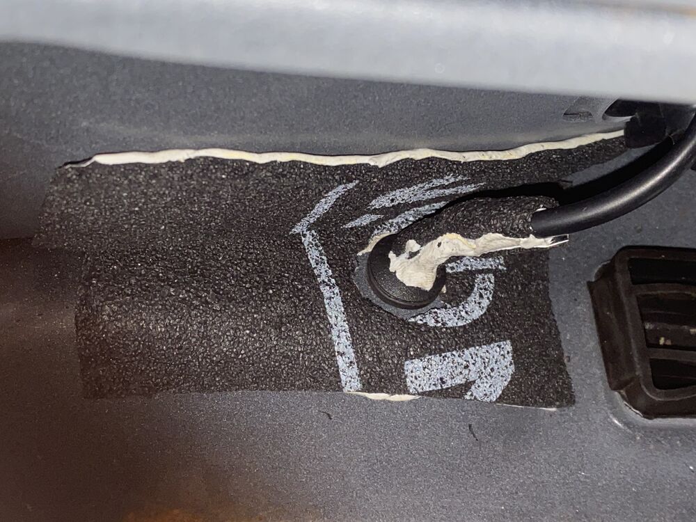

I have found the sensor in the same place as you , steelbytes.
Today I have stuck insulation on the metal and sensor cables inside to battery/footwell (see photos to follow) to see if lowering the internal convective heat might help enough to improve the readings. Seemed like the easiest first step. Yet to do a test run.

Robert, sounded promising…but wasn't. Initially the onscreen temperature perfectly matched a thermometer that I carried. (Ambient temp was 17degC). But after riding for 10km it has risen to 4.5degC above the ambient.
So, I feel the only solution is to relocate the sensor to a place that is not effected by either radiator or motor heat. Since the wiring runs through body channels to the scooter floor - that didn't look to be easy. I have not made any more progress
