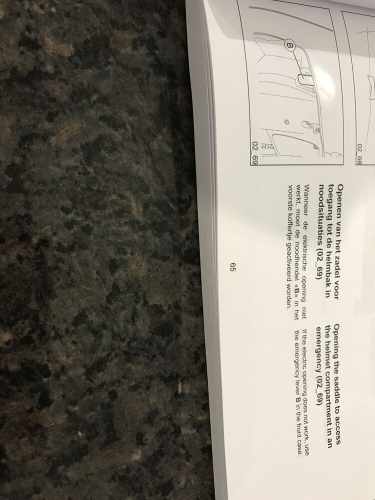

Hi, new to the Vespa. Inherited the bike from my sister in law who passed away. The bike is completely dead and I cannot open the seat to charge. Can anyone give me some advice please? Email me if possible.

Sorry to hear the news about your Sister in Law . To open the saddle you have to open the glove box/ front case , put the key in the ignition and press in , the case lid will open . Follow these instructions from the Elettrica hand book

thank you so much. I am now charging the bike. appreciate the condolences.
