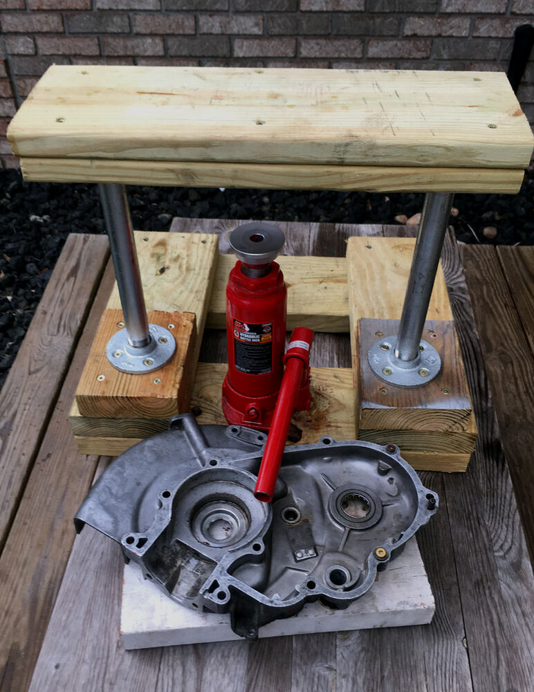

Thanks! This might just be the liquor talking, but why pay someone $10 or $20 to use their press, when I can dig out some scrap wood and my small bottle jack and bodabing Bob's your second cousin twice removed.

I have no idea how any of y'all got this bearing in without a press, but congrats...I made some modifications to my engine stand.

If, in the future, someone comes upon this thread...the moral of this lesson is:
1. Don't take it out unless you absolutely have to...
2. If you do, which I regretting doing due to my hubris, use a press to get it back in...
Just saying...
