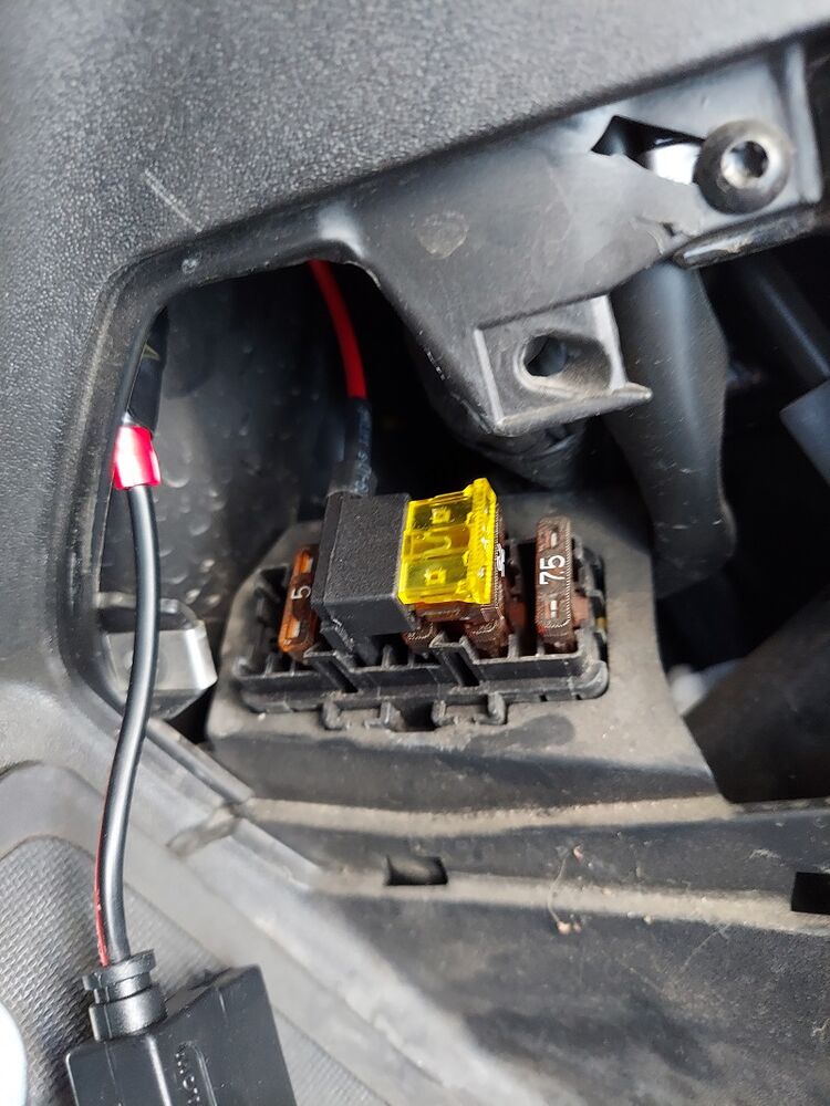

First I considered installing a 12V "cigarette" socket which would allow me to install any compatible USB plug or device that fit. However placement of this would have necessitated cutting plastic and pulling power from somewhere. Wherever I got the power from, it HAS to be linked to the ignition key so I don't drain the battery when not in use.
Power for the 12V socket would have come from a "Fuse Tap" that would allow me to get 12 volt power with sufficient amperage to power whatever device I put into the socket. But which fuse to use? Turns out Fuse #11 that provides the USB plug is linked to the key and has the 12V needed with ample amperage capacity available.

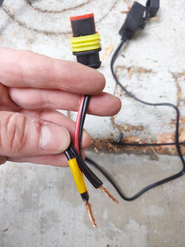

Once removed and un-plugged the wires a few centimeters above the critical plug for the wiring harness were cut. The wires were then carefully separated then spliced together with the SAE DC wires of the replacement MOtopower USB plug (also carefully cut and labeled) and secured with weather resistant Wire Nuts. A quick check with the power on showed I mixed up the polarity but no harm appears to have come of it as once corrected the USB plug worked perfectly.

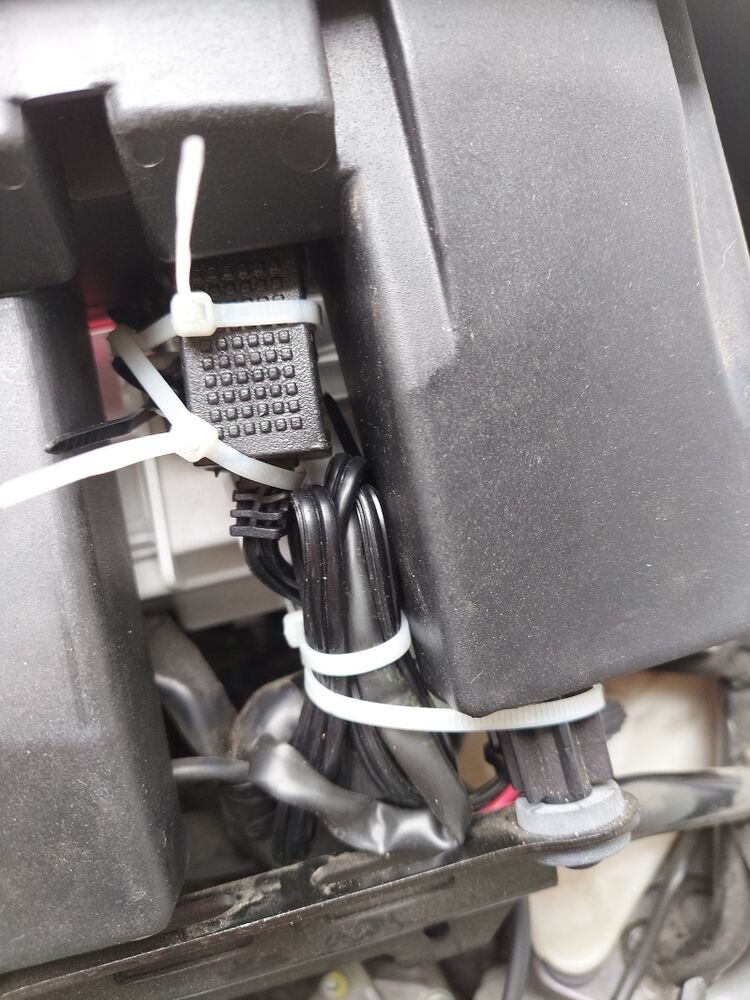

With power secured the replacement USB plug was pushed through the existing hole in the glove box then secured with zip ties to available strong points in the area. I will return to it with some more proper and longer lasting fasting solution but for a draft one and test cycle the zip-ties work fine and hold it in place so it does not push through when used.

Hidden Fuse 11 with the Fuse Tap

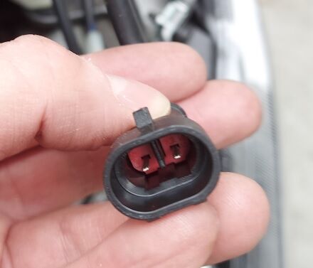

Wiring harness connector leading to the USB plug produced 12V
Splicing the wiring harness plug into the USB plug.  I got the polarity wrong on the first attempt but it works fine once my error was corrected.
A bit janky looking with the zip ties but its solidly in place until I think of something better.
Glove box side looks okay (for now) and is out of the weather.

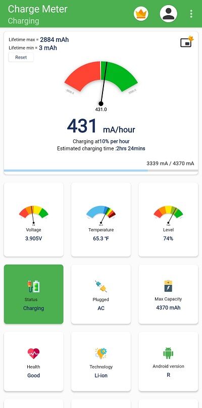

Phone App using default Piaggio USB plug shows only 430 mA/hour being provided.

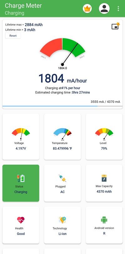

New MotoPower 3.1 Amp USB plug reports 1,804 mA/hour
