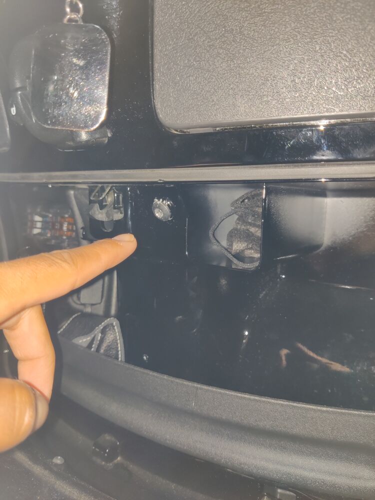

I'm new to the forum and the Vespa world. Having a bit of a nightmare here since I decided to change the original bag hook with a metal hook instead which involves removal of the glovebox.
Long story short I managed to round off the screw inside the glovebox itself Facepalm emoticon and I need the part number to order a new one. Unfortunately I cannot find it anywhere. If anyone knows this info please share.

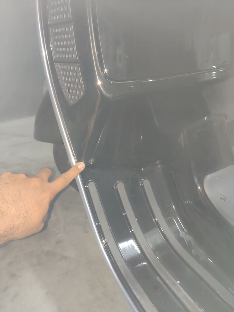

Along side this I also removed all other glovebox screws during my attempt. Howver when putting the screws back there lower left and right (longer screw) won't grip on. Is there something extra I have to do in order for it to grip.
I've attached 2 images of the issues above.
Thanks in advance!
Screw rounded off
Screw rounded off
Screw won't screw back in

I would remove everything again to compare that hole with the others to see what is different. Test the screw without the panel on.
1.) Does it catch? If so, is it the right screw for that placement?
2.) Does it slip? If so, try the other screws to see if they catch and try the "bad" screw elsewhere.
If the screw is bad, you can take it to a hardware store to find a workable replacement. If looks is an issue, I'd you can find the same screw size in use from a hidden location to swap with the new, different one.
If the hole is bad, try what suggested Fritz suggested. If you want an easy old woodworkers trick, place a flat toothpick in the hole and then insert the screw. That should hold for a while while you track down a more permanent fix.

I think the other posters have forgotten that these parts aren't held in place by plastic threads. Metal clips (sometimes with machine screw threads, sometimes with a bent piece of metal simulating a thread) straddle plastic tabs, and the fasteners grab onto those.
The clips fall off, rust, and otherwise get lost very easily. I've taken to smearing a dab of R3000 adhesive in the bent part of the clip before reattaching them, so they fall off less easily. Replacements are easily found at Home Depot but are much cheaper by the dozen on Amazon.
They have a variety of names but I think of them as "automotive clips."

for the screw in the glovebox, maybe you can pound a torx bit into it and ease it out, otherwise you're looking at a removal tool or drilling it and extracting. which, ugh. on the other one, I think it's probably just hung up, or more likely, it's just spun in the fastener and you can pull it all out and replace.
good luck!

Quick update for everyone just in case someone else has this issue. I ended up going to the garage and they checked the screw which was rounded (it was a T30 and and not T25 like the remaining screws! That teaches me to try work in day light and not with a torch)
Now regarding the two longer screw at the lower part of the glove box. They have a little metal clips behind the plastic which the screw holds onto. When I opened the screw and took it out they dropped out! Not the best design and the only way you can put them back is to take part of the floor panel and place them back on.
Thanks everyone for the help!
Make sure you get them the correct way round. The longer screw goes on the outside and the shorter screw goes on the inside as there are rubber hose pipes behind the glove box which can get punctured.
