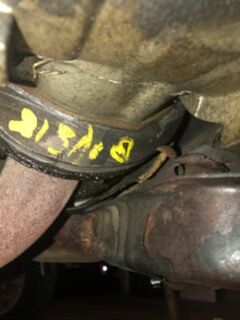

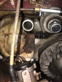

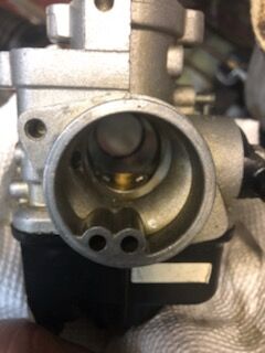

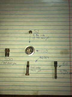

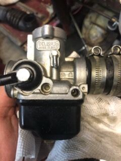

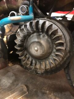

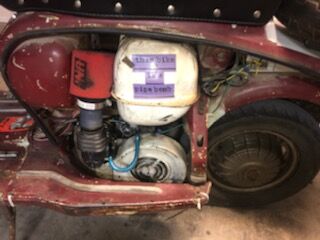

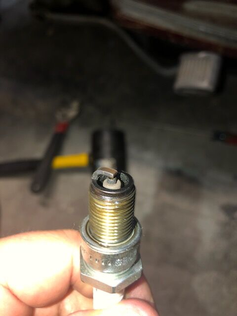

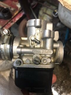

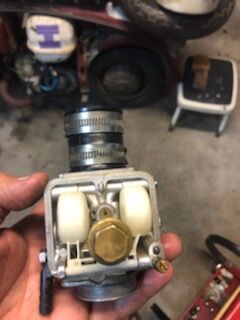

Here is the first batch of pictures. I must admit that I hardly looked at this Lambretta, I didn't know on what side the flywheel side was because I never gave it a good look.
The first 2 pictures is what the Dell'orto 25 PHBL currently comes with.

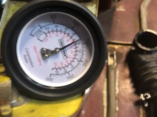

I tested the compression and it reaches 145psi but after 30 seconds it drops to 100 psi. Spark plug looks great to me, it is a BR7ES.
The yellow numbers are written on the cylinder. I was told it had a 175 cc, I believe it. I don't know why the pictures are so degraded in quality.

there is a wire retaining ring that holds the dished cover inside the flywheel fins. There are 2 ends that stick up that you can grab with pliers or something similar. Once the clip is out you can rotate the piece, which has tabs, so that the tabs can come free and the piece come off.
Underneath there is a flywheel nut, like normal, and you need a puller to get the flywheel off the crank.

Plug looks lean. Brown would be better (for this). Timing could be low. Flywheel nut is a left hand thread.
In stock cylinder setup they're not as quick as equivalent Vespas. If it gets to a genuine 60mph you'll be doing well.

Thanks folks.... Any comments about the compression hitting 145 psi but dropping down to 100 after about 30 seconds? small seal leak?
Also, how does the jetting looks? I asked on a lambretta forum but very low replies and contradicting responses. One person said 110 main jet is too rich and the other said it seems too low.

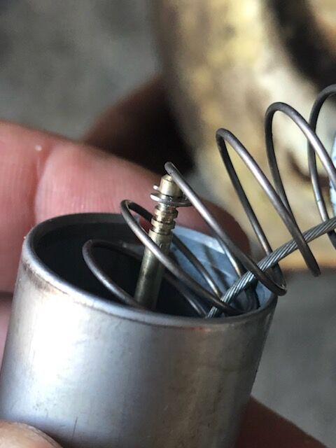

Ok fair enough, I think you've also been asked about the needle and clip position which also has a factor in how the carb operates?
The needle and clip are inside the slide, they need to come out to get at the number which may well be a D26?

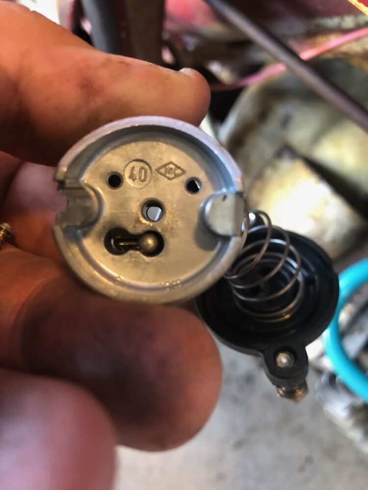

Hi again, so it looks like the clip is on the top position. A small shipment of parts arrived today from scooter-speed but I still don't have a flywheel puller. I got a new BR8S plug as recommended by scooter-speed and I am about to switch for a different blue Ducati CDI.
On what position should I have the clip ? top(like it is now) middle or lower?

Ok so I definitely think you have a fuel issue that you must address first. Like Jack said, the plug is lean. Do you have anything larger than what is installed currently? You mentioned a 110 MJ. If you dont have anything larger, you'll need to buy a variety pack of larger jets.
Then you sadly need to buy a needle pack. If you look closely, you can see whats stamped into the current needle. It'll be a letter and number ie. D25.
As a general rule of thumb, when you raise the clip (lower the needle), you clean up initial acceleration. Thats why acceleration was better a week ago with the clip at the top position, and why it ran like shit today (when you lowered the clip to the third position).
So, find the main jet that feeds the engine enough fuel so that it doesnt run hot, and then play with the needle and clip to clean up initial acceleration.

Well... I think I reach the end of the road and I don't want to deal with this Lambretta anymore. I placed a small order of some bit and pieces but I am not satisfied with the performance. For all I know the 50-51 mph might as well be the performance limit on this lambretta but to me it is utterly insufficient, I need to be in the 60-65 mph (GPS) for me to be happy.
I did order a full set of jets(10 sets), I tried a 120 main jet and it didn't change things. I am honestly tired of being slow and I don't want to dump money on a cylinder kit and other things, that is why I have the 3 vespas with cylinder kits.

A last throw of the dice
Try using a 100 main jet.
Good luck
My cast iron 230 uses a 108 MJ with a bgm clubman.
Oh and second clip down on the needle + reduce your pilot jet to a 45
Good luck and keep hold of the old girl.

So I received a Tachometer, I plug it in and I was seeing 7600 rpm in first, 6200 rpms in second, 5900 rpms in third and only 5500 in forth gear, that was with a 122 main jet. Prior to that(all the previous years) I ran a 105 and a 110 because that is what it came with the scooter.
I knew the engine had more on it, if the engine really had the 175 cc kit that I was told it had I was expecting at least 55-60 mph. Never in a million years would I thought that I would have to run a 100 main jet considering that I have a Uni foam filter, a 175cc top end, a 25 Dellorto PBHL and a clubman knock off. The gamble paid off!!! the main jet solved it all.
I expect the scooter to reach 60 mph tucked down. I saw 6400 rpm in 4th today (5550 before I change the main jet) and I know the engine could rev up to 7600 rpms (it wouldn't rev that high in 4th though).
Anyways, I am very happy, I had two options in mind: 1) putting a cylinder kit 2) selling it. For the right money I am still open for a sale unless you want to trade your Honda monkey plus I give you cash.
