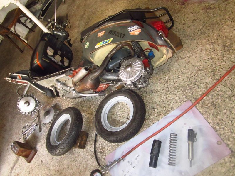

Leo Vince makes a nice pipe for the PK. I ran it on mine for a while, then modified it to put in my 50S w/ 125 motor and it does add some power, though louder than stock.
My PK50xl2 w/ DR70 kit and 19 carb did 50 or more when it had this pipe on.
I had to cut and weld the header pipe because the PK has a cavity underneath in front of the motor the muff tucks up into.
