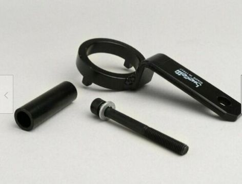

I started to replace belt which when I saw old belt it was ready to go. However when I came to take variator off the tool I had is a no no. I have checked with Fowlers and they couldn't give me product no for tool for my MP3 300 Yourban Lt 2012 is
Any other yourban owners out there can you help. I have mailed piaggio but no reply so far

That's tool I have but blades are so high the pegs are no where near the holes

Just get the proper Buzetti tool. Very inexpensive investment if you plan to be a long term owner. I am about to install my 5th belt, so that tool has more than paid for itself already.

That is for yourban lt yes. Ped parts it's only £23 so that's great ty so much I appreciate the help and your knowledge you have imparted on here
