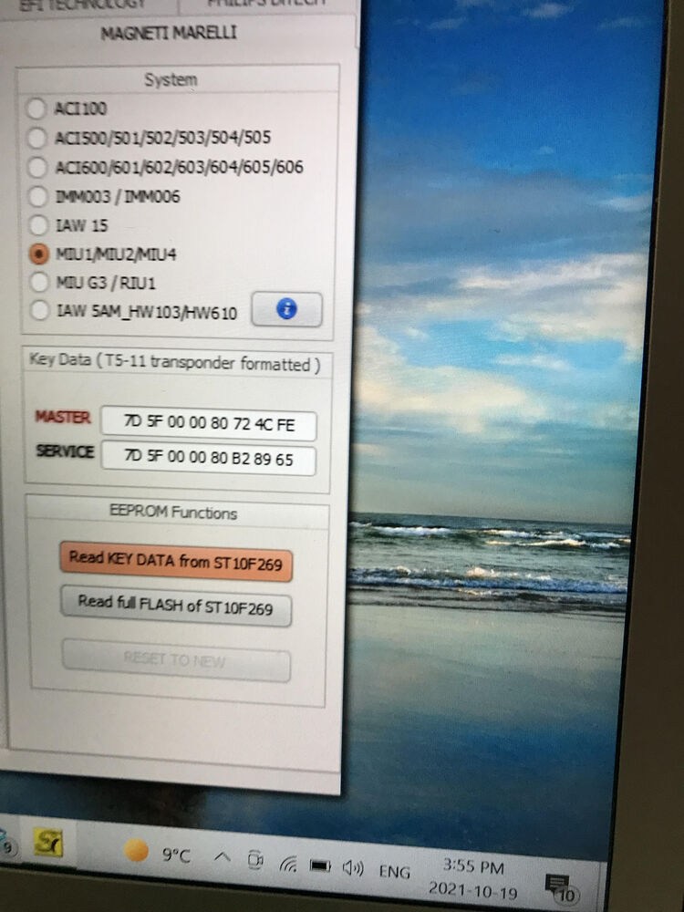

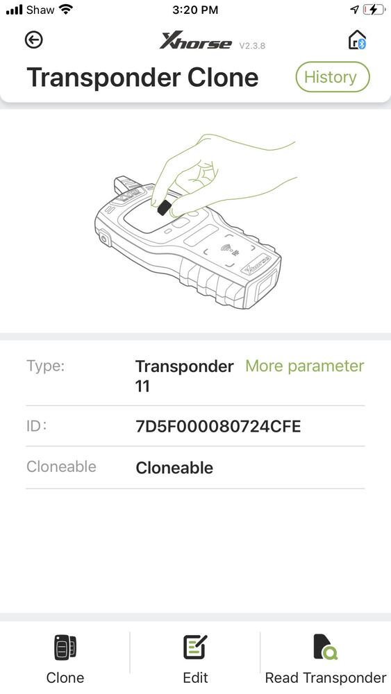

Need some help! I purchased the adavnced scooter workshop tool and was able to read the key data of my 2006 vespa gts 250ie, Was able to obtain the master key data, and then I purchased a VVDI key tool to program the chip with the id number. When I put the chip close to the ignition and tried to turn it on the red imosbilser light flashes twice and then remains solid. So please give me a hand if anyone knows about this. Thanks

What chip were you trying to program? Normally, cloneable keys are one-piece, no separate chip. The Piaggio Master keys cannot have their chips cloned.

i bought this gts with no keys, and I'm trying to program a master key for it

If you mean a new Piaggio master key - no chance. That chip is not cloneable. It's the ECU that has been programmed to the original keys. You could always send the ECU in to AF1 Racing to get it "virginised", or you should get a cloneable blank - a Fiat or Lancia dealer, or a very good locksmith should be able to help.

I just have a few more quick questions I was able to purchase a tool that plugs into the ECU and I was able to read the key code data, my only question is it possible to put that data into a blank chip so I'm able to use it as a master key

I don't know if separate programmable chips exist - but suitable cloneable blanks (that you will have to get cut) certainly do.
As above, ask an experienced locksmith.
