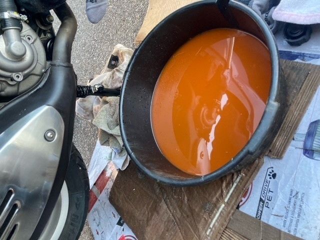

Ouch. I'm pretty sure it's supposed to be pink.

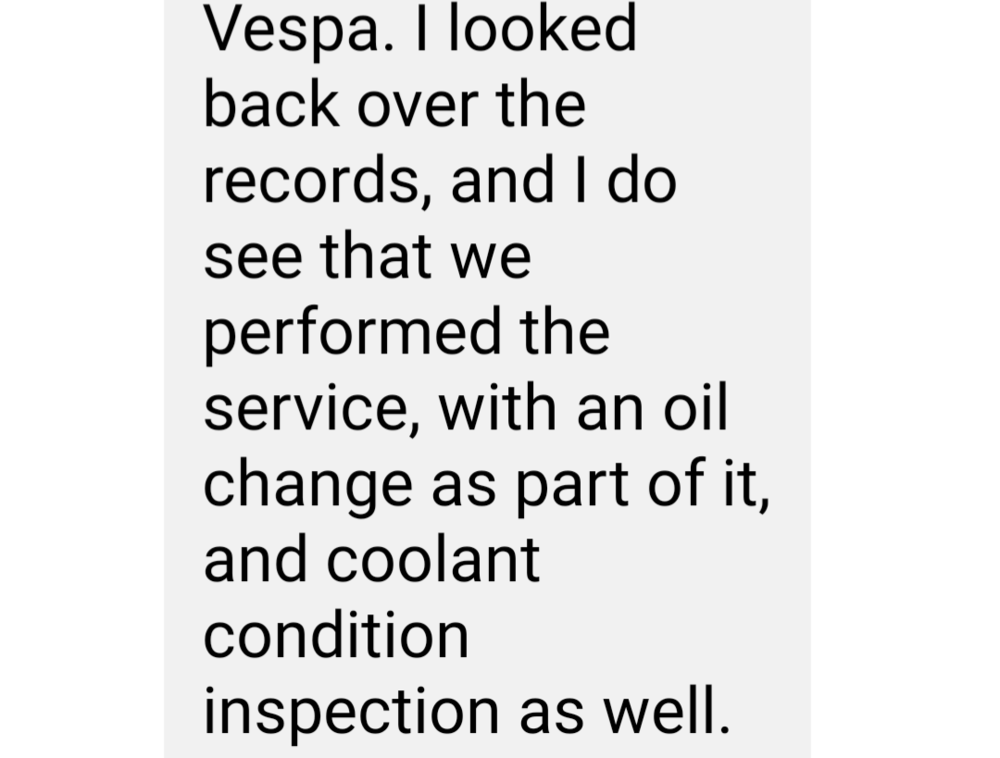

Actually, I looked at my correspondence with the dealer and he didn't actually say the coolant looked good, but he did say it had been inspected. Here is a screenshot of part of my conversation with him about this and the alleged oil change (the oil also looked filthy)...

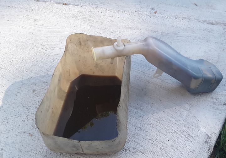

Sweet bike color, but that coolant looks like shit. I had a similar problem. Once the coolant gets over 2 years old, it isn't too effective at controlling corrosion. Flush it will a bunch of distilled water (or a flush product and distilled water), then do a coolant change with an appropriate OAT coolant. Here's what my coolant looked like after the previous owner let it sit for three years…

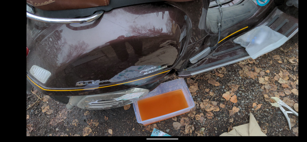

I pulled this out of a 2006 Yamaha Morphous. It's an Arizona scooter, and has never been changed. It's supposed to look like lemon lime gatorade. I wonder what treating your engine like this does to the lifespan of the bike?

Nope, the system was filled with rust that was the same color as the coolant.
