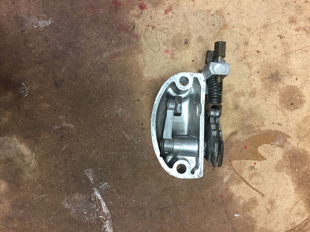

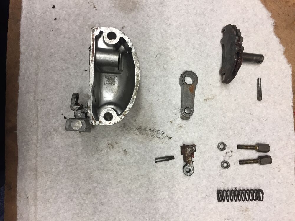

OK, so I have the selector back on and installed a fresh set of inner cables. Flushed the cable sheathes with contact cleaner and cable lube. Nice and smooth movement prior to attaching the cable the the selector. It's still very difficult to shift though. With the clutch pulled all the way in (when riding) the shifter needs what seems like a lot of torque to change gears. Did I miss something?

Can you shift smoothly through the gears without the selector box, using just the rod? If not, the issue is inside the case, not with the selector or the cables.
If the gears shift ok using the rod, try hooking up both cables to the selector box and shifting through the gears without the box attached to the engine. You should be able to click through all the gears smoothly. If not, it could be the box was re-assembled incorrectly or needs lube.

I found a video instruction on this and will give it a shot tomorrow. I'm thinking it might be the selector spring tension. In the videos, their batwing seems to turn/click in an out of gear relatively easily with minor to moderate tension. Mine can barely be turned by hand. Also my spring was very difficult to compress into its recess when I reassembled the box. More to follow.....

Everything seems OK with the selector rod. With the box off, the shifter was still very stiff. I removed the spring and it's buttery smooth. I ended up dremmeling off two coils from the spring and now she shifts a lot easier. Thanks for everyone's help.
