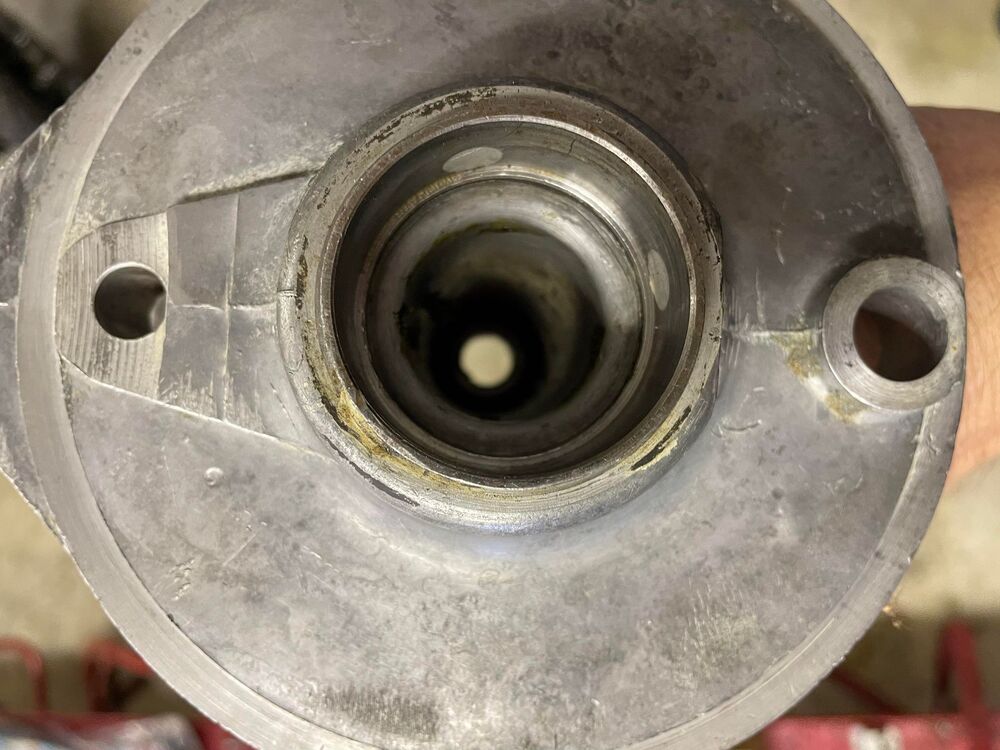

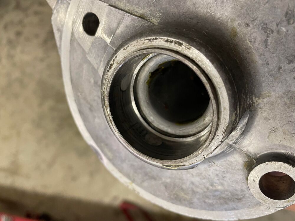

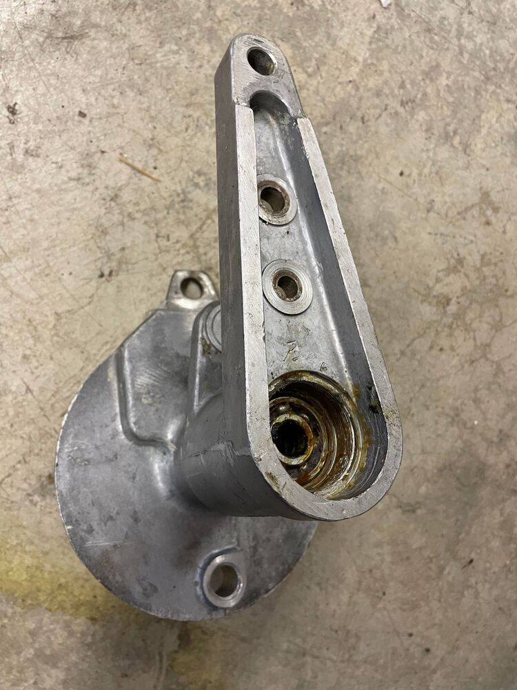

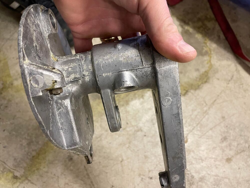

I would like to upgrade the pogo stick on my 62 Allstate on 8s. This swingarm is being offered to me as a used Piaggio marked swingarm. Will this work? Can I use existing hardware, or do I need to change some bits?

yes, it'll work.
Not sure if you'll need new bits or not. Someone else will for sure chime in on that.

Should be a direct swap over, with all the hardware you have. Consider using new selaed bearings while you have it all apart anyway.
You'll also have to weld on a top shock mount to the fork tube. If you get a complete fork, you can leave the Allstate fork as-is, collecting dust on a shelf for future use or restoration
