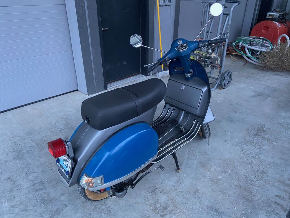

Hey guys,
Not sure if I posted this but about a year ago I pulled the trigger on a 1980 P125X that has a real nice (not perfect) body. I got it for $1200 and am very happy with it. It started right up when I was at the sellers house and also ran when I got it home. However, it was popping out of every gear. I have been extremely busy getting our winery building finished and the business open so it has sat for the last year slowly leaking two stroke oil. Now that I have the business open I have a bit of time and want to get back to this thing. My hope is to have it rideable by the time it warms up for some summer fun.
So...Before I dive in what do you think I am looking at to get it to stop jumping out of gear. And what will be involved getting the 2 stroke oil to stop leaking?
Cheers,
Alan
