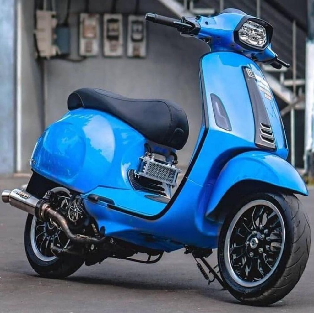

Unless it has a fan behind, I can't really see much air flowing through that oil cooler in that location under your bum and behind your legs...
Love the black/blue combination...

Odd, that. Would like to know more about this.

Where are the engine connections for the oil lines?

The oil cooler is placed there to keep your legs warm in winter.
I actual made a vent in the service hatch were that oil cooler is hoping my lx125ie would vent a little warmth with my apron. It does a little when driving slow.

The person with the oil cooler has punched the Sprint up to 200ccs, so the extra oil capacity and cooling probably does help.

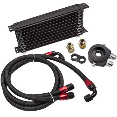

Hi would this lot work ..looks like possible male to female adapter needed to connect to engine and 12v supply

Thanks Syd for that .. just checked the expo on that ,the engine is different by the looks of it ,so the oil feed is different..the oil cooler on its own would work but still need something like above to feed it in an out Facepalm emoticon

I doubt it. The Sprint 150 oil filter sits in a recess. The edge around the recess would prevent the adapter plate from sitting flush on the engine case.

Hi its not for a sprint but a gt

If you look at the pictures I have put up then you will get what I'm on about..

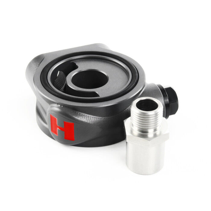

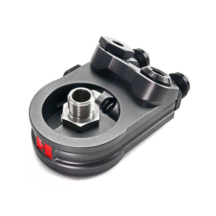

here's the deal, essentially you need to do a remote filter and integrate a cooler into it. the hang up is that there's basically zero-point-zero room at the filter location, which is where you'd tie in at. and it doesn't matter if you're doing a GT, ET or sprint or whatever. the basic architecture is the same.
also, there is not, to my knowledge, an adapter plate on the open market. which means you'd be making one; hope you have a machinist friend who works cheap.
so let's say you whip up an adapter, now you're faced with the problem that you only have so much room for your supply lines. which means you're likely cutting the case and moving the exhaust OR them supply lines are gonna be tiny.

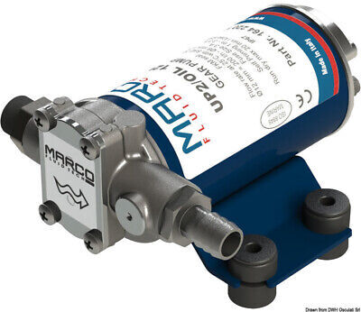

the other possibility, I suppose, is that you could do circulating system, which I don't love. you'd need to pick up pressurized oil off a port in the case (pressure sender probably) and then either tap it back into the system thru a drain back galley via the case (plug) or you'd punch a hole in the sump and drain it back into there with a restrictor, maybe, probably.
but again, you're talking pretty small lines. so most of the capacity is going to be the cooler. which, with all that you'd be lucky to see a 1/2 quart increase.
the filter adapter is the correct way to do it. the other way will work, but that's some real amateur hour garage goblin kinda work.

Hi greasy, I'm looking to go down the 1st route you mentioned, getting some sort of adapter made ..luckily my friend has a machine shop and he's prepared to let me loose in there lol.

The water pipes run under the plastics ,so was hopefully going to follow the same route. Will mean enlargement of hole and new grommets..
Next problem is exhaust in the way of oil filter if protruding out too far..
Solution..re run exhaust to come under the floor with side exit (possibly removing side stand) ,which then will leave room for a belly pan, (px style)
