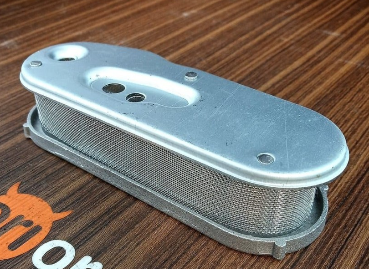

Do you use bigger air filter for 20/20 carb? Like air filter for PX
PX series air filter
If youre using a PX 20/20, definitely use a PX filter. That way the idle screw and body fit correctly.
