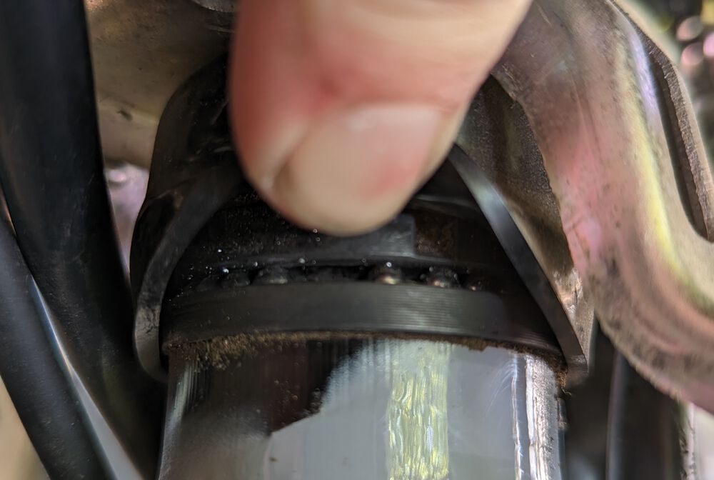

well the top does look bad when I take a peak under cover (haven't yet unbolted the bars). There was a lot of dirt / gunk, some wiped away in this photo. Could see plenty of metal sparkles and a couple of missing balls at different points around. Think I saw some actual metal pieces before I wiped away the gunk. I wonder about the condition of the bottom ...
here's a pic of one of the missing
PS, does't appear to be any cables binding
yeah man, those are roached.
you could just order the bearing and hope for the best. but if you're feeling frisky I'd blow it all apart and see how bad it is that way you can make a battle plan.
out of sight, out of mind on the bottom.... Goofy emoticon

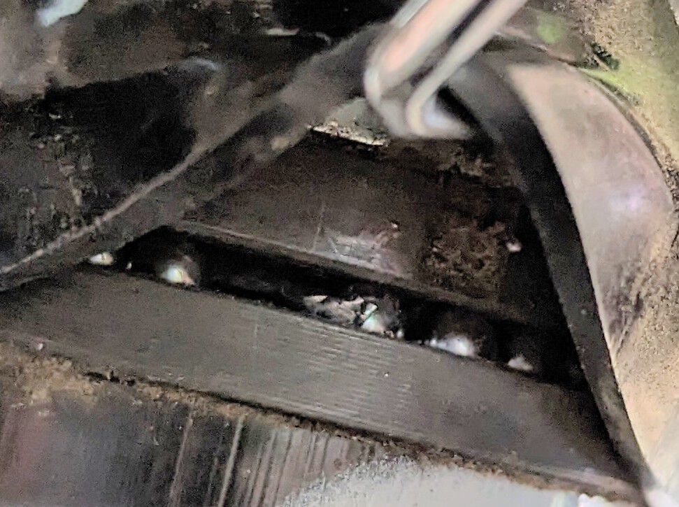

Mashed cage like potato and missing balls

When you replace the bearings, and the races if needed, you'll be in the "major repair" club. I've done headset bearings on a Honda Helix, bearings and races on a Honda Hawk NTV650. A few Honda CBR900RR's, both races and bearings. And several others along the way. Ironically the worse one was a Yamaha Zuma, 1998 vintage. The races kicked my race removing tools butt! The bottom was the worst! But once done it steered so lovely!
Park tools makes a race punch for bicycles but I've used it on most all of my headset overhauls. Your'e kinda lucky, I didn't have YouTube back in the day. All was done out of a paper service manual.

I did this on my Big Beo a few months ago on the floor of my garage, after the notch developed after 14 years and 24k miles. It wasn't anywhere near as bad as I thought it would be. I probably dropped $100 on tools for the lower race stuff but easily saved $500 in labor.
The new bearings and races were $50 from Motovista's mart, and the largest expense was a set of bearing pressing discs from Amazon. Once you have the pressing discs, you don't need a huge bolt to squeeze the races back in - just a few feet of cheap threaded rod, and some nuts and washers. This was less than $15.
After several tries and some very bad swear words trying to get the lower race in straight, I ended up using half a can of freeze spray on it. This turned out to be a much better tool than the swear words and worked on the first try.
Getting the old races off the bottom of the triple tree did also require a propane torch and a Dremel. The dainty little articulated spanner wrench to get the upper bearing nuts tight is really not necessary. A few taps on a screwdriver worked fine.
I think my scoot was out of commission for three weeks on this project as I did a lot of other weekend maintenance in the vicinity since the triple tree was out (changed oil in the shocks, brake pad and rotor replacement, etc.). This was my first time doing most of this work and I can see why somebody depending on a single machine for transportation - and perhaps not so intrigued to figure out the details - would punt this to a shop. But the convenience will be expensive!
Sage words. The lower race is the hardest part.
Did my first set of scooter bearings on my '08 Majesty. Lower was a sonofab***h to get back in. Upper frame in that scoot is cast aluminum so it's a bastard to keep the race warm and expanded. Clean all the old grime off before heating with a torch, unless you like random fires in your frame. Get the biggest threaded rod that fits and multiple thick washers, I used 3/4" (19mm) rod.
Did it at my local scooter dealer. It was educational for both parties...I learned that they'd never swapped out steering bearings races before! Wha? emoticon
I throw them in the freezer the night before - same effect, less cost. If its still snug, heating the neck a bit helps, too.

greasy125 wrote:
take it in then. mustn't interrupt the flow of wobbly pops!
while it could be done, and I have done it on the ground it sucks super bad. even more so if you don't have the right tools for the job.
it's understandable to tap out on this one and take it to a pro.
I got it done last week at the shop. Now it's slippery and I'm getting used to it quickly. Would almost like a steering dampener as I'm not yet sure how it's going to handle bad unsealed roads ...
Anyway, was chatting to a friend and he made the comment that the nut might need slight adjusting after a little while as the bearings bed in. Thoughts?
funny how bad it can get and you just get accustomed to it and then when you have the new parts fitted it feels alien to you!
regarding the bearings, there's many different viewpoints on this. all I can say is sometimes they do, and sometimes they don't. that's why there's always a check at every service interval.
but now that you know what to look out for you can probably adjust them yourself. however if something is going to "slip" or "bed in" it's likely to happen in short order and you'll notice. if that does happen get it taken care of quickly.
It's not just the feel when riding that's changed.
Before the bearings completely failed - ie for the last year or so - when sitting on the lights I could rock the bike slightly back and forth without my hands on the handlebars (thrusting with my hips) and it would stay straight. But now when I rock it the steering quickly moves to the left, I remember my old gts did this movement to the left. Not saying it's an issue just an observation. Does seem to still keep straight when briefly taking my hands off while riding so all good anyway
