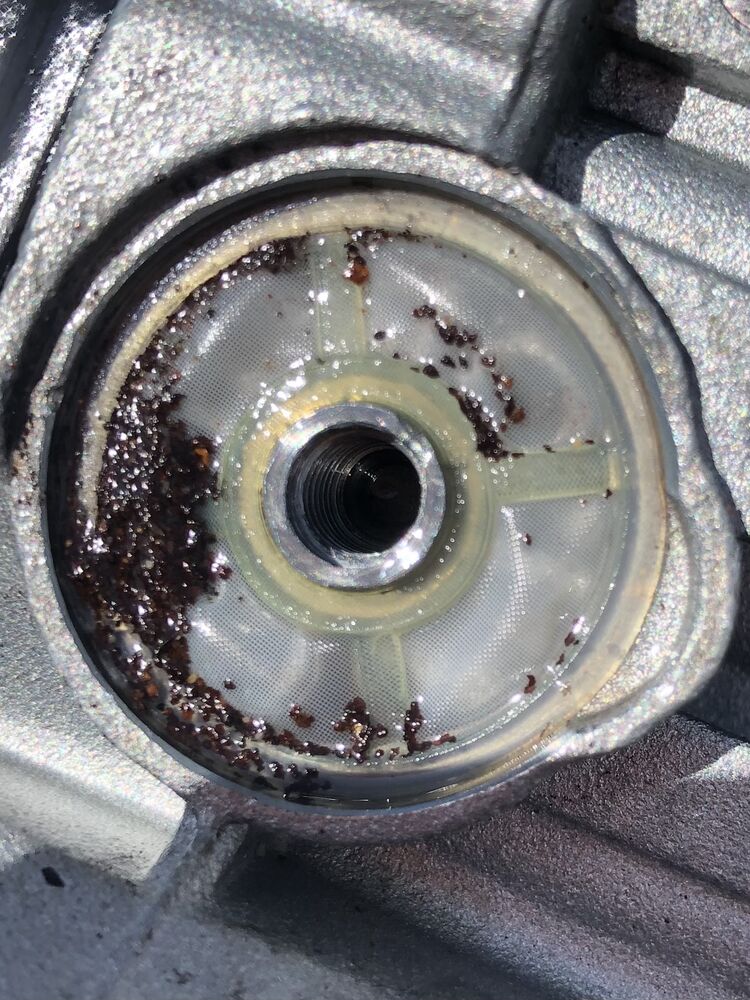

So I've just taken my SHBC 20mm carb off the Pk and the shit in the filter is off the scale. It was cleaned around October and has been driven for about 400 miles. It's 35 year old scoot so clearly the tank has issues, possibly more apparent with ethanol fuel stripping off the crud in tank that was relatively happy before using e5. So we get the carb spotless stripping down and cleaning and you don't really know when it's fouled. Has anybody tried in-line fuel filters with the see through glass? At least then I could just take the tool caddy out under seat and visually inspect the in-line filter and clean that out rather than the rigmarole of full carb removal and tear down . Any pitfalls in using them ? Any recommended makes if you do? Thx in advance.
Cruddy mother funster

Your gas tank is losing the coating inside. That is the metal flakes from the gas tank walls.
Yes I thought as such, I don't think e10 helps as it has ethanol which has detergent properties hence buggering up an old tank and stripping the shit off it once tolerated by e5. A certain amount of Rust inside tanks is normal over time just from condensation. That's why I Thought in-line filter was my plan until getting a new tank . IMO hopeless to try and treat as the ethanol will muller the coating process as discovered by others, you get a black carbon looking smudgy deposit. Probably have to get new tank but whether pk xl tanks still available I don't know . They have the px Efl type fuel sensor and gauge fitting hole .

One bit of advice that was given to me for small frames was to get a quick disconnect for the fuel line so you can pull the tank without having to touch the carb. You could then mount the filter by the tap and upstream of any other plumbing.
I haven't really even begun my smallie project yet, but that seems like a totally solid solution to me.
Sun Jun 26, 2022 7:11 am
PX 200
Joined: 25 May 2016
Posts: 750
PX 200
Joined: 25 May 2016
Posts: 750
Sun Jun 26, 2022 7:11 am linkquote
This opens up another hot topic.
I always wanted a quick disconnect… because of the carb removal was getting too frequent and I was talking to a friend who mentioned he was getting vacuum problems as it wouldn't prime properly the hose from the connector to the carb.
I don't know if it is a one off thing ie. Fill once and it'll be fine every time it's disconnected, or it will gain air bubbles over time.
I don't know… but I always wanted to install one. Granted they're longer than the in line fuel filter which poses a bit of a problem
Sun Jun 26, 2022 10:10 am
Parmakit Primavera -74, Polini Primavera -68, Stock GL 150 -59, VMC 177 Bajaj Chetak 125 -95
Joined: 22 Jun 2022
Posts: 48
Location: Finland
Joined: 22 Jun 2022
Posts: 48
Location: Finland
Sun Jun 26, 2022 10:10 am linkquote
I have never seen any point in quick disconnect on a smallframe. To get the best possible fuel flow to the carb I don't want to have anything extra on the line. Plus every connector is a place to eventually develop drip issues. Just use some good elastic fuel hose and it's a breeze to pop it off from the carb barb.
A good lenght for the hose is when you can lift the tank sideways on top of the frame opening but not much more. Of course on milder stages of tune these things don't matter so much.
