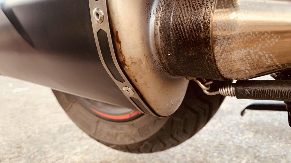

I Noticed a leak within 3 days of installation. You can see the residue from the exhaust around the front of the can near the medal band that appears to have hex bolts. What shall I do? Also, Not to forget. In the mornings I can visible exhaust fumes exiting through this area.
Noticed a leak within 3 days of installation. You can see the residue from the exhaust around the front of the van near the medal band that appears to have hex. What shall I do?

You spent money in good faith. I'd email the maker with documentation and request a new can.

Looks like excess glue / sealant used during construction. Might not matter? But definitely contact the manufacturer with photos

Give it a wipe with some kerosine on a rag!

As someone who just saved $1,400 on a furnace part yesterday because I thought to look up if I was covered under warranty (I was), definitely reach out to the manufacturer ASAP.

From Manufacture
Hello Mr. Smith,
This is an issue, that occurs from time to time, but is not something we aim for, so please, contact your dealer and file a warranty complaint for the matter.
Best regards, Rok Ilc

Did you get it from an Akro dealer in the US?

ScooterWest.com was the dealer*

First off, those look like rivets, not hex bolts. It also is not excess glue as one poster suggested because you said you can see exhaust coming from the area. I would call scooterwest and tell them about it, and see if they want you to send pictures. Also tell them about the email that you got from Akropovic. Ask them to e-mail you a shipping label because you should not have to pay postage to return it or to receive a replacement. Also ask them if they will include a new exhaust joint bushing at no charge. Good luck. I am interested to hear how good their service is after the sale.
