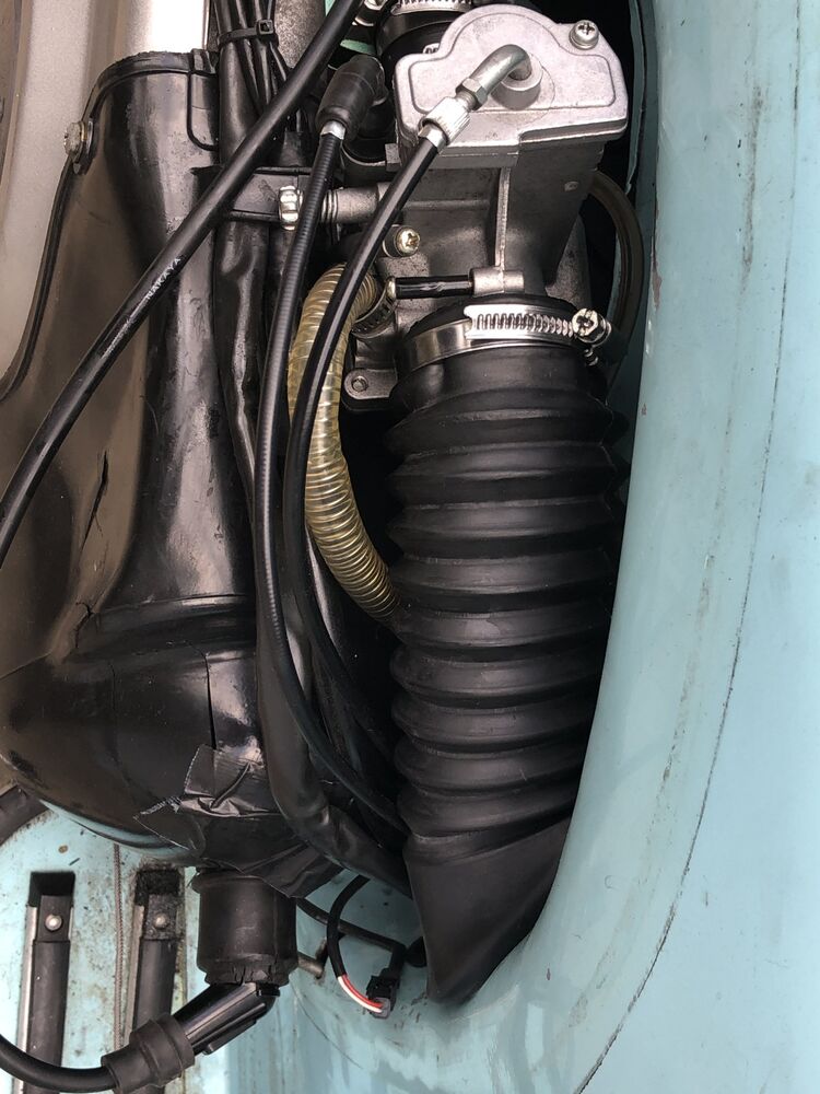

I need to find a better plug connection, this one keeps hitting the motor cover. I had one with a 90° angle but it hit also and got broken. This one is shorter than stock but still to long. Any recommendations? I think I need to use a different boot around plug hole. This is an old cover I drilled a hole in reserving my new cover.
