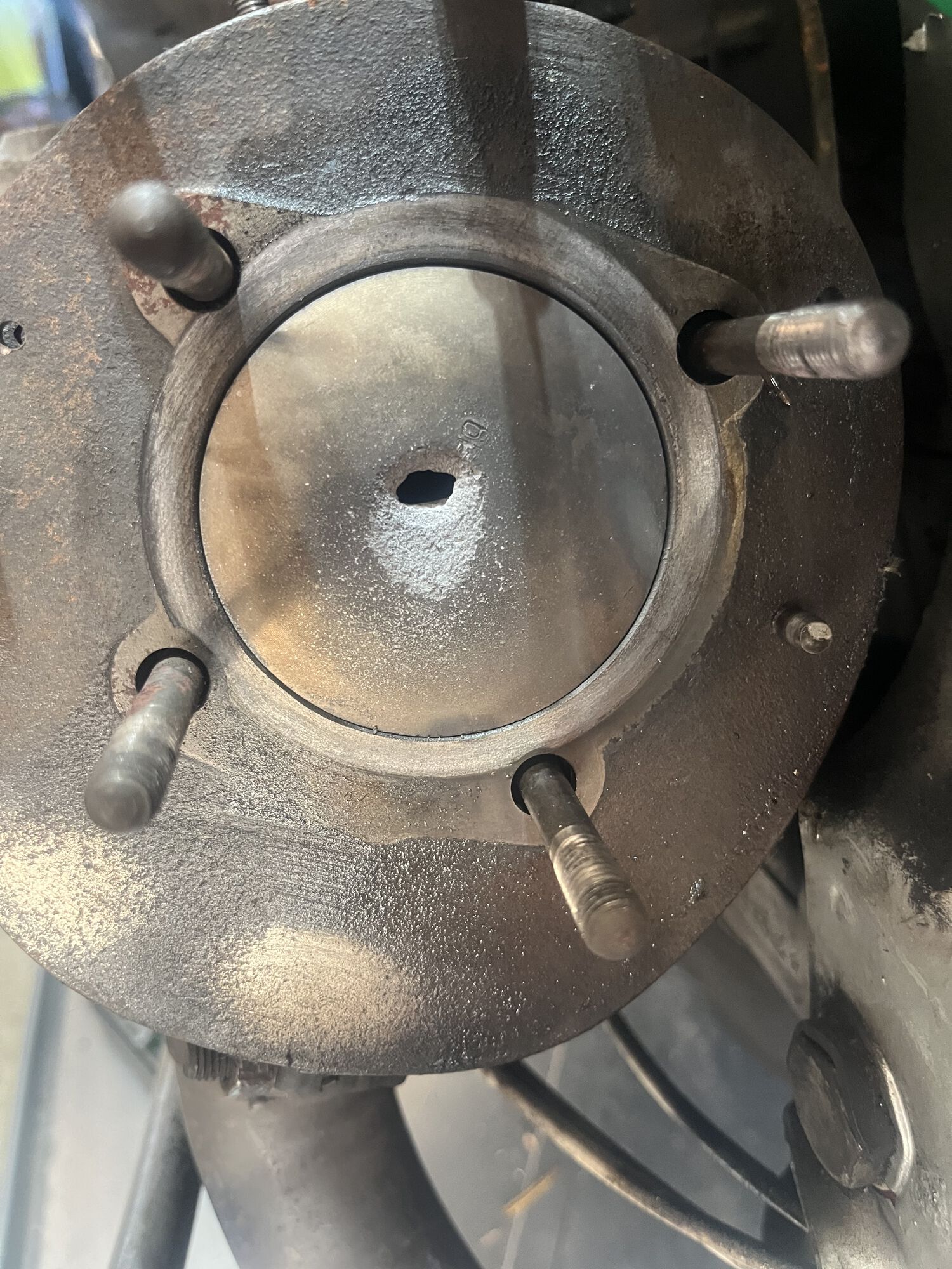

Did you ever figure out what this scoot was? I picked up a GS160 last year. It's super fast…rode it for a year, switched points after encountering some running issues. Then put a hole in the piston thrashing it on a ride a few weeks ago.
Turns out it's an old school upgrade similar to Eddy Grimstead's Hurricane. It's SS180 cylinder bored out to 66.5mm standard P2 piston. I'm having a new piston welded up to get it on the back on the road.
It's not a Hot Rod Al build, might be Kerrie from San Diego area…I don't know him🤷.
Haven't cracked the case, so not sure what gearing is in it.
I'm also building an GS160 Eddy Grimstead Hurricane style engine. GS case, SS180 cylinder, gears and primary drive with a P2 65t gear. Standard 62,0mm piston…
