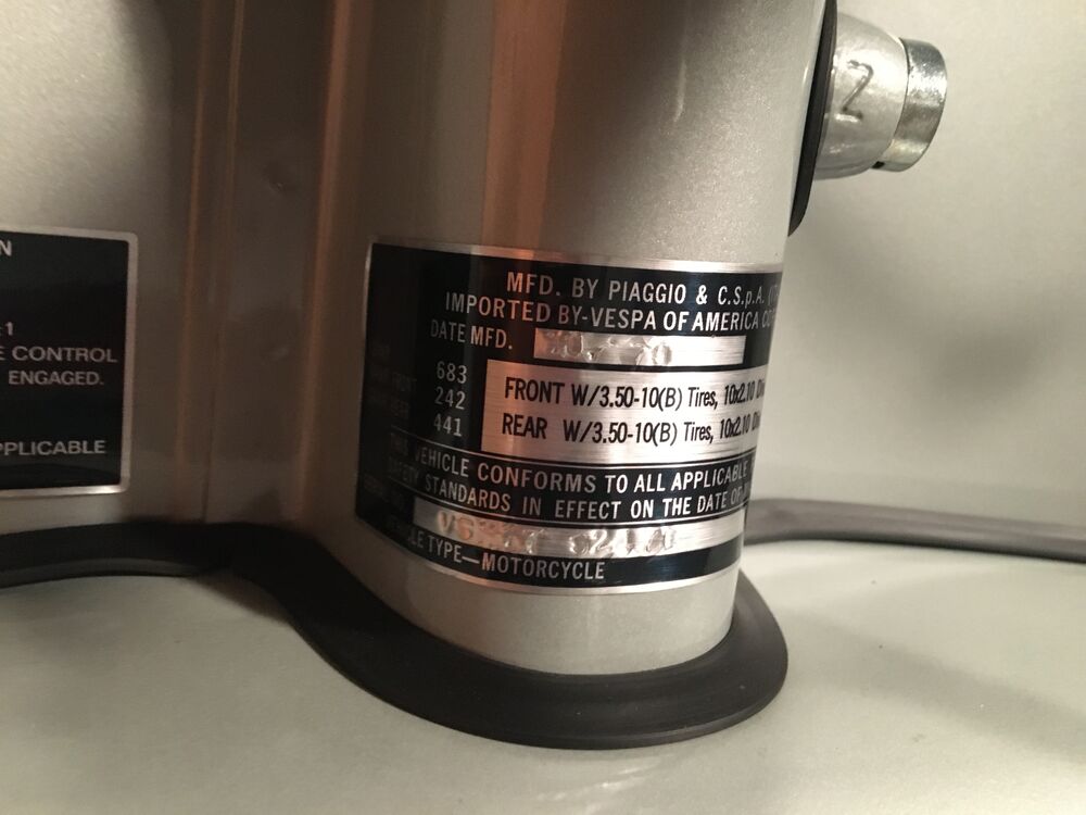

Do think that's a misprint on the Repro? Here is my original. It's a little blurry but it reads 79 Octane.

Might be a different year.
Those aren't exact. They're made of plastic, not aluminum. but they're very close, and a detail that always gets lost with paint.

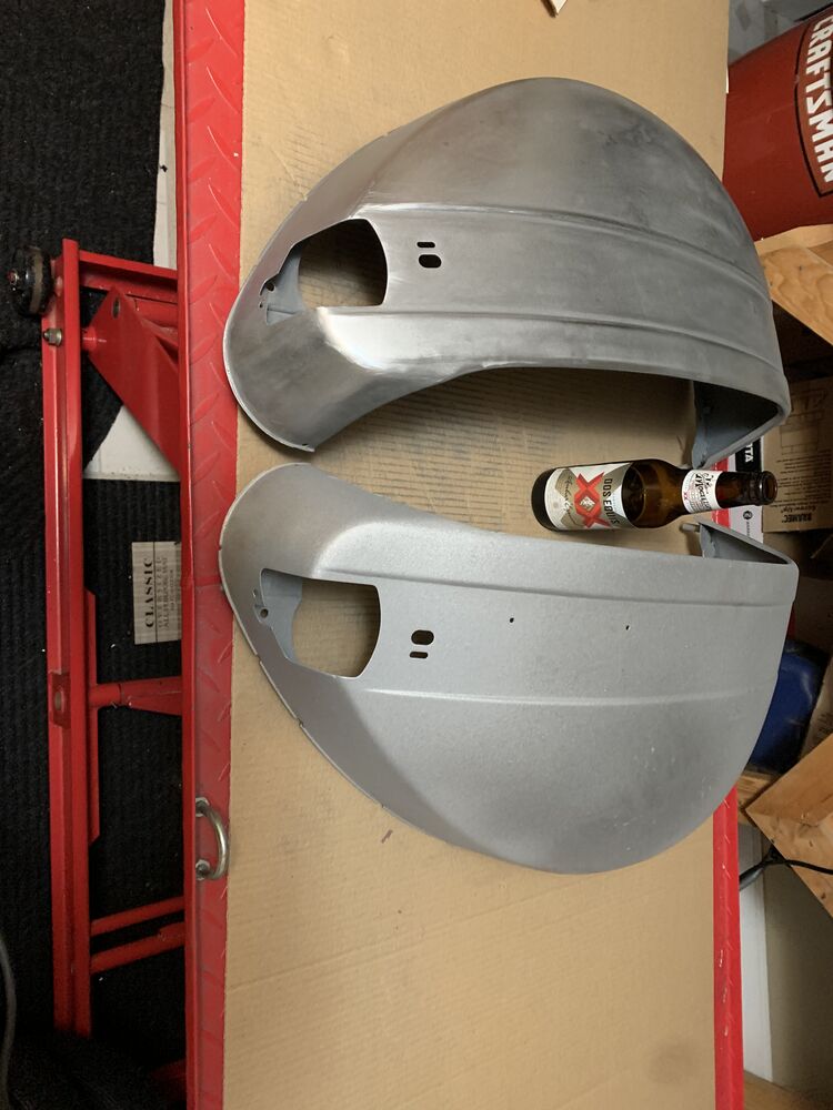

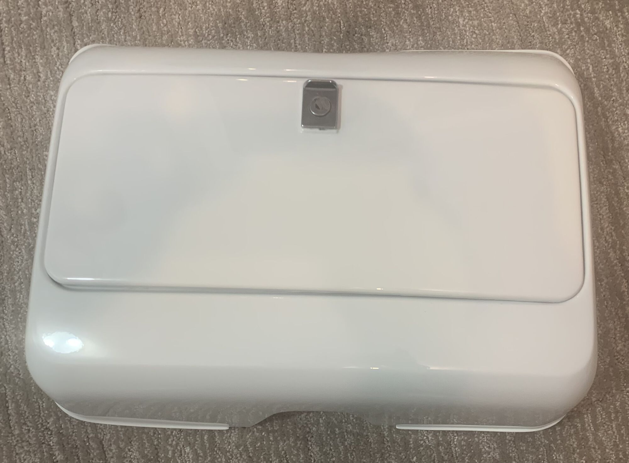

Here are some pics of my progress. Sanded right cowl, glove box, and front fender. Still need to sand left cowl, gas tank, and frame. I forgot how much I hate sanding by hand! Crying or Very sad emoticon Hand sanding is the only way to get in all those tight spaces though!
Got my rims back from powder coating so I mounted the new tubes and tires. Note that the rim studs have powder coat on the ends! Details details. Finishing up my Dos XX break so back to sanding👍.
One Cowl sanded.

Fender
Fender
Glove Box
Glove Box

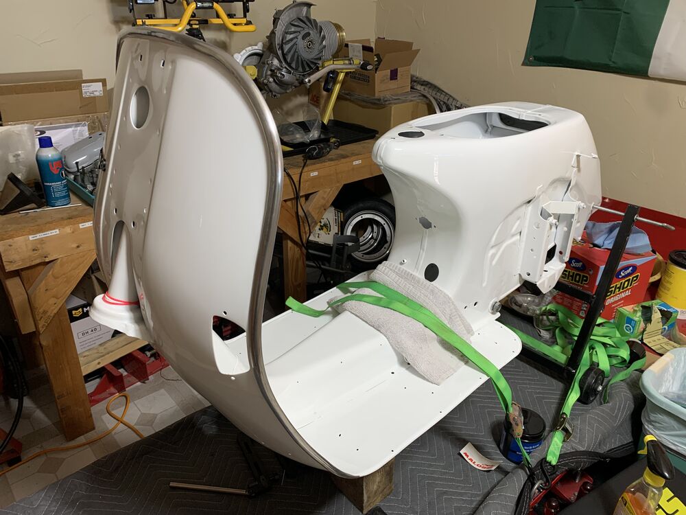

Update
I worked some more on my 1980 P125X. I started sanding the frame. I spent 6 hrs on it today and got about 60% done. Still need to get the fender well and fork tube with 150 grit sand paper. Then hit the whole thing again with 220 grit sand paper. I also knocked out the lower fork tube bearing race. All fork bearings and races are being replaced.
It's getting closer!
Enjoy!
Hec

Legshield half sanded
Hand sanding stinks
Hand sanding stinks
Half sanded
Half sanded

Did you have it blasted, then sand, or did you sand it all from the get-go?
I can't recall, but it's looking great either way!

Thanks Chandlerman,
Yup all metal was sandblasted. If you look closely you can see the light pitting in the metal that the sandblasting produced. My painter wants me to sand it all down vs trying to fill in the pitting with hi build primer etc. This ensures that body lines stay crisp. The pitting sands out easily but it does take time. The glove box door didn't get sandblasted as the sandblaster was afraid of it getting heated up and getting distorted. I have watched the youtube videos of the Asian guys refinishing Vespa's and some use a Torch to remove all the paint. Wha? emoticon I wonder how much metal warping that caused? That is probably why they coat the entire thing with body filler!
