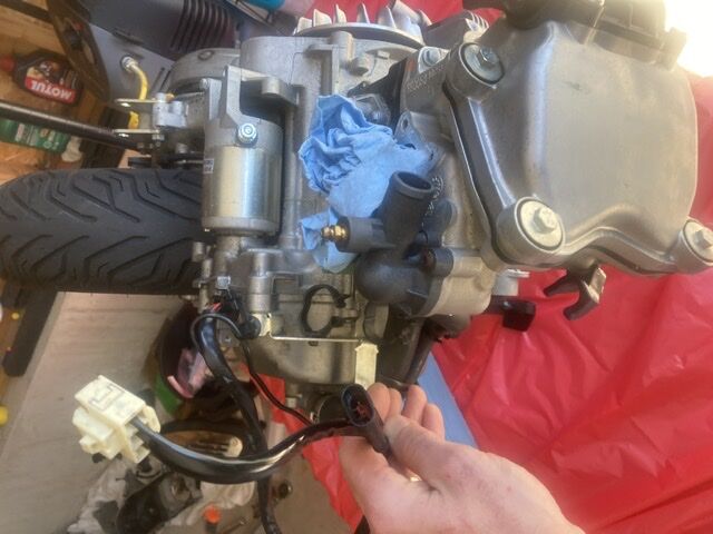

I've got coolant leaking from somewhere. See pic. It appears to go away when I'm riding, and then return once the scoot stops and cools. Any thoughts on where it could be coming from and possible repairs to stop it? I've checked all the hose areas and they appear dry. The thermostat location is dry. The water pump housing and weep hole are dry. Thoughts?

I had a leak like that on my 2009 GTS 250 when I first got it with 20,000 miles on it. I read that it was the head gasket. I replace the head and base gasket and the problem went away. I wasn't a big leak when I found it.

Agreed. Run it hot lately? Pull the pet carrier to see if the leak is from a hose.

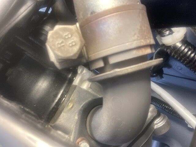

There aren't that many places for coolant to leak. I know it's annoying (I had a similar leak on my GT200 at one point), but it's much easier to find the leak now in your garage than on the side of the road 25 miles from home!

if it's just the clamp, then replace it. no special tools or skills needed.
if it's the gasket, then eventually it'll blow out. damage to the engine is most likely to occur. and these things seem to happen at the most inconvenient time.
get it repaired if it's the gasket.

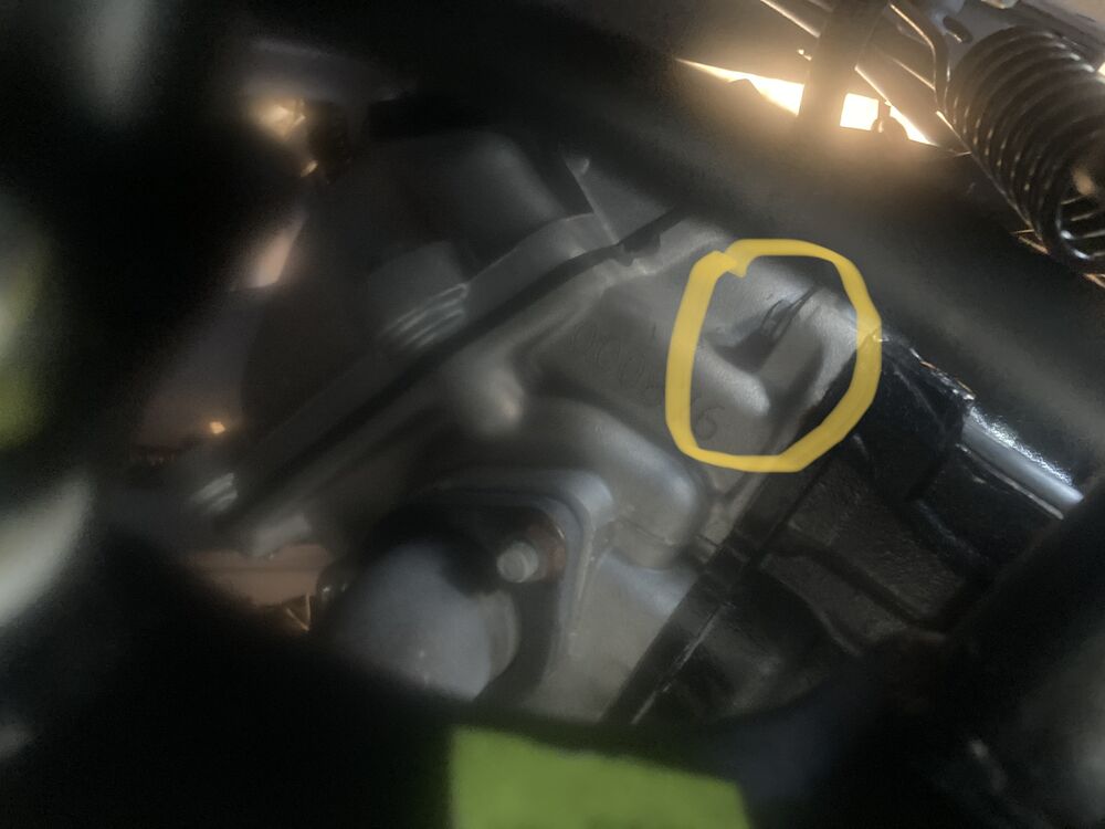

So, I think I have traced the coolant leak to the circled part in the pic. I don't know much about engines, but is there a gasket in that location from which the coolant could be leaking?
Posts: 45942
Posts: 45942
That's your head gasket - and a prime suspect.

Thanks, Jim. Any thoughts on checking/torquing these (cylinder head bolts, maybe?) to the proper 11 to 13 Nm (if they are indeed the cylinder head bolts)? Perhaps that could potentially compress the gasket just enough to stop the leak… Is that possible? Could it hurt?
Posts: 474
Posts: 474
The gaskets are metal with a coating on them. If the coating deteriorates and flakes off in the area around coolant passages it will start to leak. This happened to the base gasket on my BV 350.
The job isn't as bad as one might think, and due to the easy removal of the pet carrier and lack of plastic panels on the Vespa I suspect it is much easier to repair than it was on the BV350.

Thanks to Greasy and the other awesome forum members, my wife and I got the engine out! A few questions:
1. Do I have to replace the base gasket? I think it is fine and just the head gasket is leaking.
2. Do I need to re-ziptie all the electrical zip ties I cut?
3. What should I use to replace all the "one time use" clips I snapped? Worm gears? Other one-time use clamps? Is there a brand someone recommends?
Thanks again!
2. yes
3. worm gears are fine. make sure you get ones that don't have holes as they are apparently more likely to damage the hose? not really sure how much it matters but play safe. and get stainless steel
I think the GTS uses the same studs to hold the cylinder and the head? In other words, by removing the head you must also disturb the base gasket. Personally, I'd just spend the $10 and get a new one for the rebuild.

As was mentioned - you are releasing the torque on the base gasket. It should be replaced. You should be able to (gently) turn the crankshaft until the wrist pin just becomes exposed, remove the clip and wrist pin, and remove the cylinder and piston together. Done correctly you don't need a ring compressor because you never remove the piston from the cylinder. It is literally nothing more than a few extra minutes of work.
Thanks again!
you and the missus are amazing!
1- nah. in fact I wouldn't touch it.
2- sorta kinda maybe. I do mostly but not all of them. use discretion
3- 100% geared hose clamps (dealers choice here)
on the hose clamps there's opinions of shielded and non-shielded. personally, I've never had a problem with run of the mill worm gear auto parts store clamps. just get something decent that's not total dog shit and you'll be fine.
