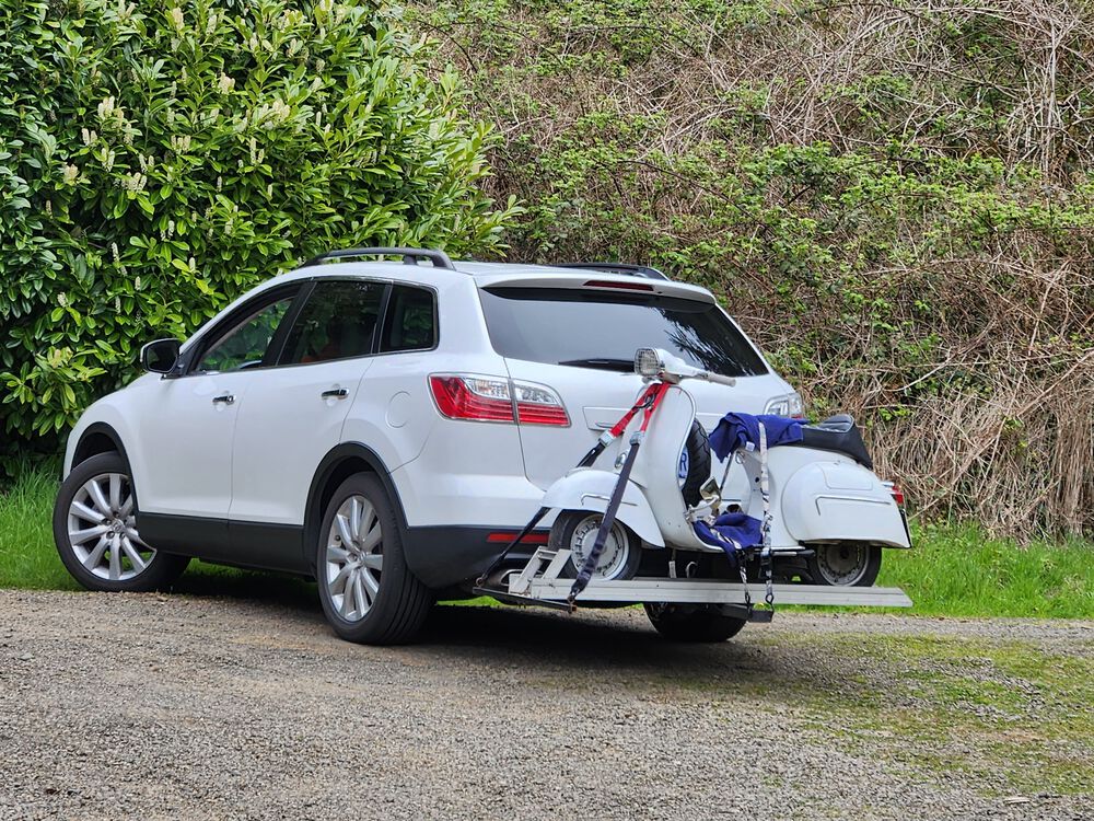

One of our local club members in Eugene bought a package deal consisting of an SS, a couple smallies and the GL. He already owns a GL and a smallie so up for sale they went. I was all excited about the GL for a bit then talked myself out of it, qascooter (Scott) got hot on it for a while but cooled his jets. Scott and I had talked about it several times both getting hot and cold I think secretly hoping the other would buy it. Enjoying a build getting to ride it all you want while the other guy pays for it, what could be better? 😀 So in a moment of weakness I ended up with it and I'm super stoked.
@scootnewb avatar
P200
Posts: 80
Location: Springfield, Oregon
@scootnewb avatar
P200
Posts: 80
Got her home and spent some time cleaning her up a bit and sorted through the box of parts just seeing what I've got.

Changed the oil, the old stuff looked good, cleaned the carb and loaded up and headed to the beautiful Oregon coast to have Scott lay eyes on it and help me try to get it started.
@greasy125 avatar
Posts: 15122
@greasy125 avatar
Posts: 15122
hells yeah!
please tell me that the paint is decent enough to salvage. along with those grips and lever covers!
very very cool bike!
the square body Dakota veritible makes for a fine scooter toting machine!

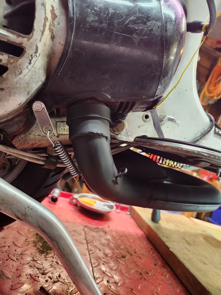

Thought about leaving my gear cables hooked up backwards just to keep my old brain sharp but decided to get them in the right position today. Great tip for adjusting the shift cables, get the shifter in neutral and mark it on the bottom with a Sharpie so you can see it from the gear selector when messing with the cables. I think Scott told me he learned it on a MV post from Sausage. Probably an old trick but this novice mechanic could have got off my stool a thousand times to look at the top of the headset and still wouldn't have thought to to mark the bottom.😀
@scootnewb avatar
P200
Posts: 80
@scootnewb avatar
P200
Posts: 80
Shift cables straitened out, a quick test rip around the block with no lights without going to jail and my granddaughters stopped by and made me cookies. Great day. 😀

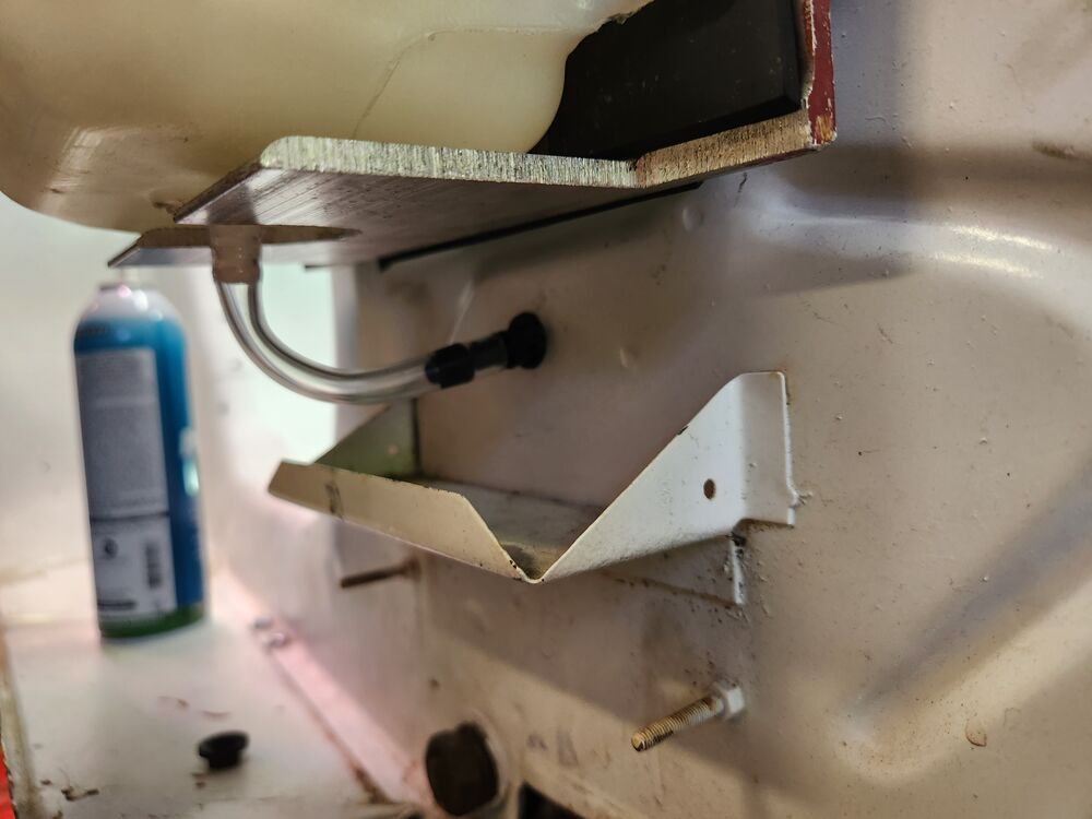

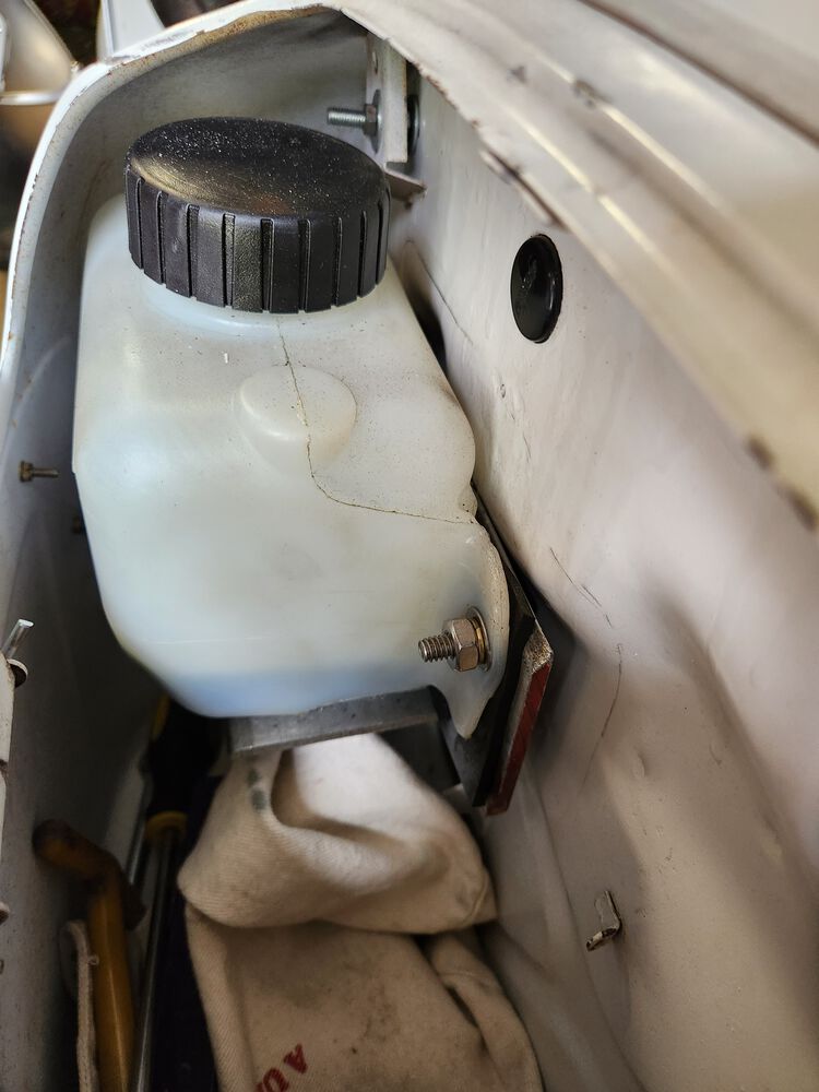

The rains have started here on the Oregon Coast. And that means it's project time!
I finally convinced Chris to bring over Lucy for the first big project of the season, which he did today.
We drank coffee, ate donuts, listened to tunes, BS'd about everything and everyone (if your ears were burning, we were talking about you), and wrenched on Lucy. Oh, and rode around town in the rain, and to the taco truck.
Chris got an autolube tank and made a mount for it, and also got an adapter for the tank nipple size differences. (Heh heh, I said nipple). It's going in the left side cowl and over to the carb.
We pulled the carb and carb box, both on finger tight, and made sure oil will flow properly when the time comes. Cleaned everything up, then reinstalled the carb with the proper washers and lock washers, torqued to 10-13ftlbs.
The game plan at this point is I'm going to make a kindergarten schematic of what is there, and then see what we're missing to go batteryless.

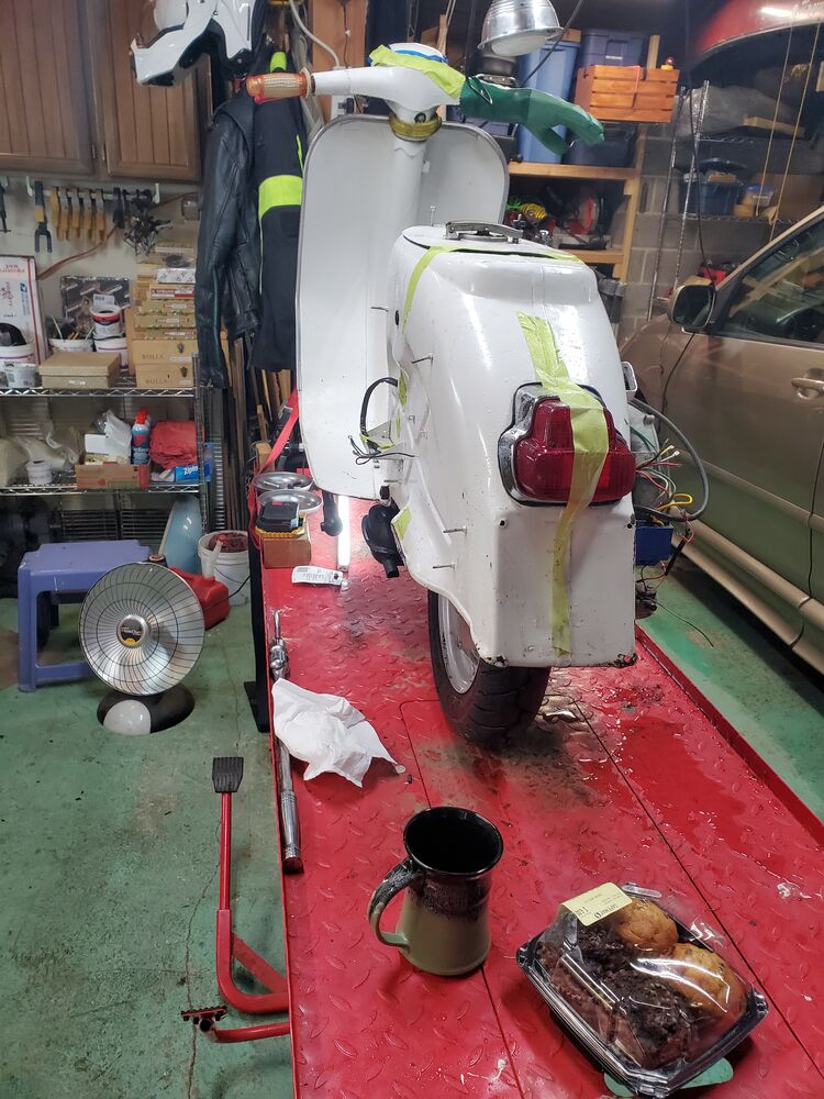

Here is Lucy, back on the table
You carry in the bins of parts Chris, and I'll drink my coffee

How cool is this oil tank!
Perfect bend and straight into the tank cavity without any kinks
Let's make sure the nuts and bolts have lock washers and blue locktite
Carb oil passage is free and clear. The oil gear shaft is in good shape too
Let's put some oil in the tank
Oh yeah, it's flowing baby, it's flowing! (Gotta clean up that tunnel...)

I absolutely love the autolube! Good on you guys for hooking it up. So what size is the oil tank? I think the Nalgene bottle that i use for an oil tank in my PK200 is 16 ounces? All i know is that it empties quick if you ride a lot. I think the stock oil tank reservoir holds around 2 quarts? The bigger the tank the better though. Another option is to fit a P series fuel tank and reservoir in the GS. That will give the GS a longer range...but that might not work because i think you'd also have to relocate the choke bracket to a different location in the frame. One last thing, is the cap for that oil reservoir vented?
@scootnewb avatar
P200
Posts: 80
@scootnewb avatar
P200
Posts: 80
I'm not sure what size the tank is but the cap is vented.
Posts: 2991
Location: Philadelphia
Posts: 2991
Mine holds a whopping half gallon!
Might only need to fill it up once a decade ROFL emoticon
@socalguy avatar
bodgemaster
Posts: 7869
bodgemaster
@socalguy avatar
Posts: 7869
I'm intrigued by this.
@qascooter avatar
Posts: 5261
Location: Florence, OR
@qascooter avatar
Posts: 5261
Thanks Whodat! Chris and I did a lot of talking about what type of tank to fit in the glovebox, and still have usable space. He ended up making some cardboard sized tanks to see which one he liked best. Then he made this cool mount at his work to hold the tank. I think it's going to work out awesome...
⚠️ Last edited by qascooter on UTC; edited 1 time
@qascooter avatar
Posts: 5261
@qascooter avatar
Posts: 5261
Ha! We looked at your tank, but Chris didn't want to carry enough to keep us both supplied with oil when we ride across the state Razz emoticon
You are actually the inspiration, so thank you!!
The conversation went something like this...
Me: Are you going to keep the Autolube?
Chris: Naah, just premix it.
You know, you could keep it by putting an oil tank in the side cowl area.
Really? That would be cool!
Yeah, FM did it on his 58 Allstate, check out the thread....
And the rest is history!
