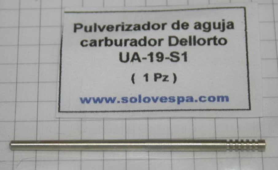

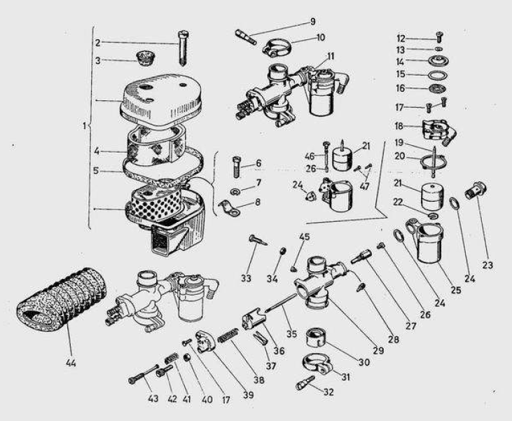

Are you using the original carb? If so, it is a son of a ... to fine regulate. You may check the needle in the floater (if it closes correctly), the floater itself (check there is no fuel inside) and the needle position in what we call "the bell" (don't know the name in english part#36). Needle is part #35 in the scheme. This needle usually has 6 positions. Try second or third groove begining from the right side in the picture.

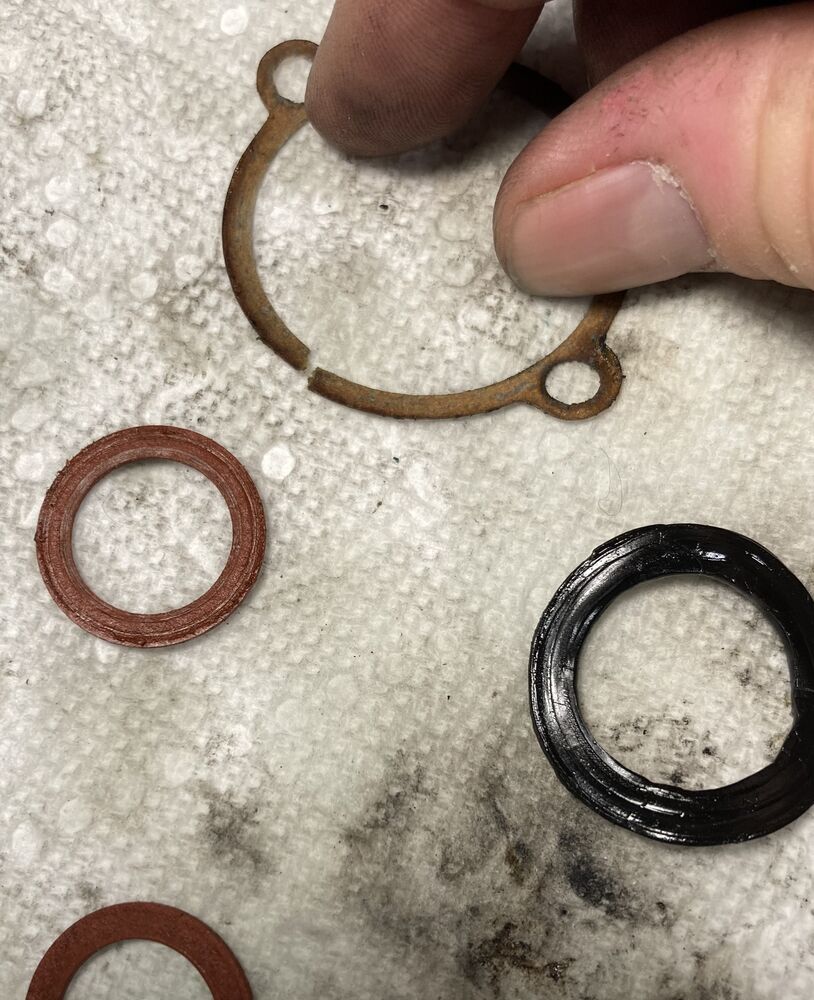

Alls well that ends well, I used fresh remixed fuel at about 4.6% because the fuel I had in previously was too oily ( don't ask Facepalm emoticon )
Additionally its a good thing I got replacement gaskets for the UA19S1 carb because some were not original and replaced with substandard or incorrect gaskets. took it all apart, cleaned, new gaskets.
Ran the old gas out, much much much better! Runs like a champ... now to fix some wires that broke from the harness...
bad naughty evil wicked gaskets
