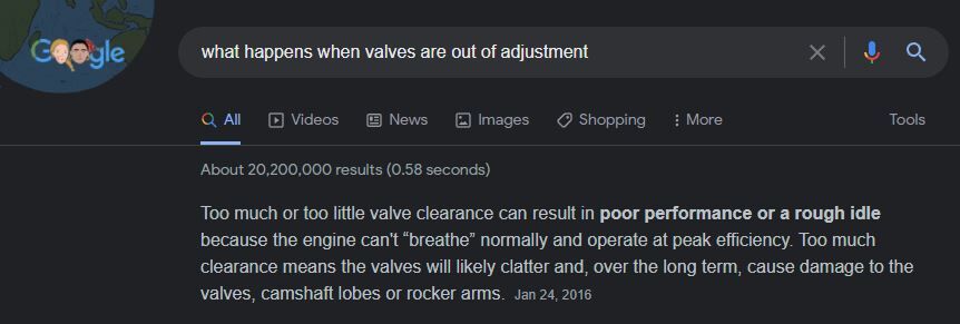

Google is handy. Motor go ouchy booboo.

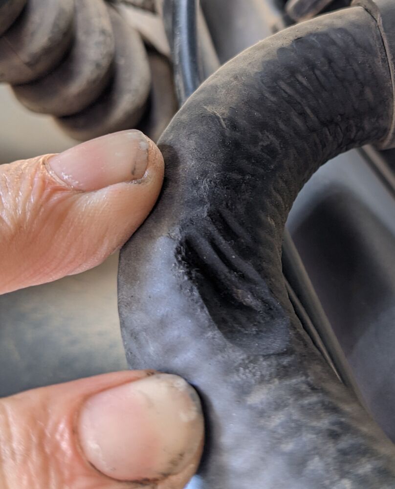

While lowering the engine i found that the coolant hose had been rubbing on the corner of the ht coil.
Fuck.
Fuck.
I think you caught that just in time.
Fuck.
Glad you caught that by coincidence instead of via "where's that leak coming from?"

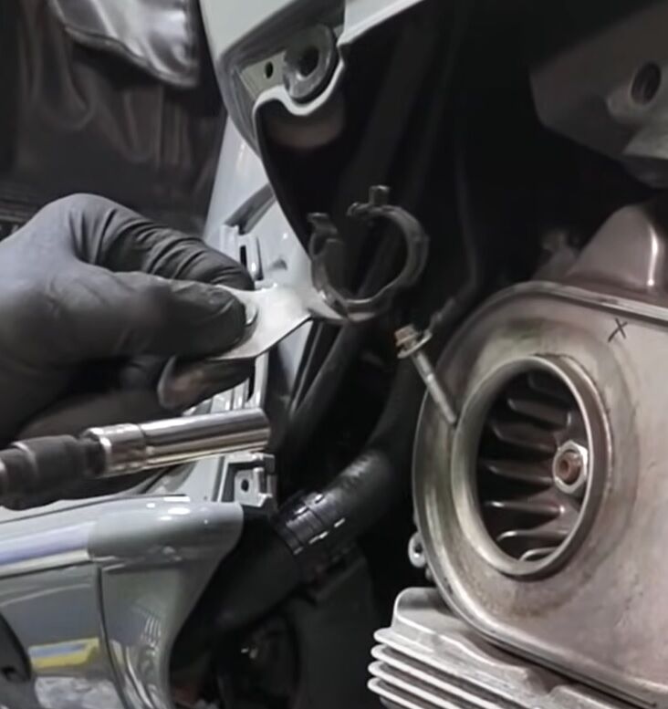

yup. It's another fuck up by my mechanic. there's supposed to be a bracket from a bolt on the transmission cover that holds that hose but the bracket is missing.
update on this: looks like the factory didn't install the bracket.
continued in Coolant hose rubbing on HPE
