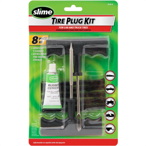

JOHNTEE wrote:
Looks like a good quick fix . What is its trade name ?
Kits are sold under a variety of names. About any place that sells auto parts should have "tire plug kits". Tip: Get the type with the T handles, not the straight screwdriver handles. Those plugs can be hard to push in.
If you're lucky.
Seriously, if it goes in easy, shove another one (or two) in there.

I found that I had a flat rear tire while leaving a restaurant twenty miles from home on Monday.
I didn't have a sticky string repair kit, so I bought a can of "Fix-A-Flat" that didn't work.
Luckily I met a guy at an auto repair shop who had a kit and he patched it.
Today, I brought my Slime tire repair kit with me on a 200 mile ride with a friend.
I noticed that his rear tire looked low as we left a restaurant 100 miles from home.
He made it to a gas station on an almost flat rear tire, we located the hole and I used the kit to patch the tire.
It held, and we safely made it home.
We were both happy that we could fix it.
I think I will carry a kit on all rides in the future.
So will he.
Bill
