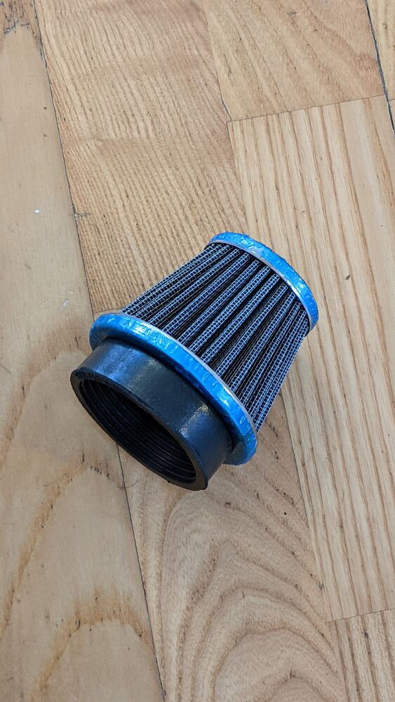

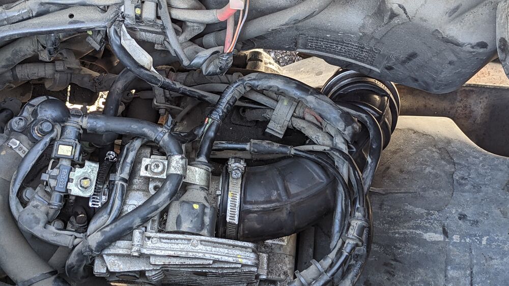

I took the 300 out for the first ride of the season and was able to go about 74 miles an hour per GPS, 84 mph indicated. This is without any modifications other than a windshield.
This morning, I replaced the standard air box with a pod style filter. We'll see if that makes any performance difference. It's definitely louder.

As I understand it, messing with the fuel mixture is a 3 part process: air, fuel, flow. Increase the intake air without changing the fuel just makes you run lean. Increase the fuel to compensate without adjusting the exhaust flow doesn't do much but make you burn fuel faster. That's how it was explained to me, at least. I haven't messed with that since I switched from carb jets to fuel injection. Remapping the EFI is outside of my current skill set.
If you're going to run a more open air intake, keep an eye on your spark plug color.
Posts: 543
Posts: 543
Airboxes are designed to provide a still air plenum to reduce turbulence, as well as to silence intake noise. Some used bikes I've had were improved by replacing the airbox if I could find one not cut open to "improve" flow.
Next step is a forcemaster, which should address fuel ⛽ flow. But I'm doing one modification at a time.

Topolino wrote:
Airboxes are designed to provide a still air plenum to reduce turbulence ...
sounds plausible ...
although I have a hunch: the restriction of the air filter would probably produce the smooth flow between the filter and the engine irrespective of what is mods are made between the filter and the open air. well, at least up to a certain point. maybe. sorta. ?
yes this hunch is ignoring the effect of length on standing waves etc which probably should be keep in tune with the rpms of the power band. ie don't fuck with the length of the hose etc between the filter and engine. switching to a pod and using the same hose running to the throttle body (like Lars did) would have minimal effect on this aspect unless the pod has such high flow that the smoothing effect I mention above doesn't happen.
hmm, just some waffly thoughts. not sure ...
