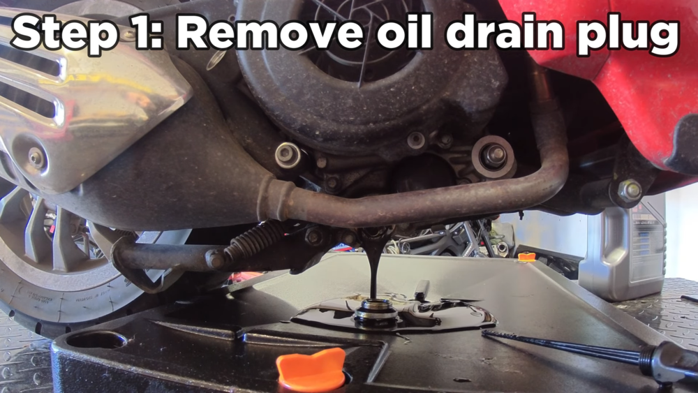

I have a 2021 300 Super HPE that needs its first oil change. This is my first time doing an oil change on THIS particular model bike. To prevent the dirty oil from running down the center stand and getting oil over my nice, sealed garage floor, I want to put a drain pain under the right side of the center stand and let the oil drain into the pan. Is the best way to get an oil collection pan under the stand to tilt the bike to the left and have someone slide the pan under the right leg of the stand, or is there a better way? When I lived in NJ, my concrete floor was nasty, so I didn't mind making a mess when changing the oil on my GT 200. Thanks for the help!

skids wrote:
I think I have seen Robot do a video where he uses a small motorcycle jack so that he can leave the center stand up.
I don't know if it is your particular model or not but I would pursue something along these lines as a strategy to keep the oil off of the center stand.
I also have a couple of old inflatable camping mattresses that don't hold air that I have saved as my oil change drop clothes, easy to take into the back yard and hose off after wiping most of the oil drops off.
At about 4 minutes is where he talks about using something besides center stand to minimize clean up
Thanks for the link! I watched it in its entirety. Excellent video. Same model as mine. Robot is fortunate to have access to professional motorcycle lifts with front wheel chocks to keep his bikes upright and center stands up during oil changes. Unfortunately, I don't have that luxury. I'll have to figure something out. Thanks again!

If you've got a second person around to help slide the oil tray, then maybe you could just ask them to hold up the bike for a couple of minutes instead?

Wasn't there a trick where you could use the pet carrier upside down to keep a GTS upright without using the center stand?
Yes, upturn the pet carrier and place it under the belly of the scooter. Great for front wheel removal and checking the steering bearings.

Plus 1 on what Berto said. It only takes a few minutes to drain when the oil is warm. If no one is around, I tie it up against the wall to my kayak pulley setup with a moving blanket where it touches.

You can always lean your machine against a wall. Then you don't need the center stand and it's out of the way. Perhaps a bit inelegant, but it works.
This suggestion is definitely doable in my garage. I can lean it up against my work bench. Thanks!

I have made custom funnels from several layers of aluminum foil to route the oil around the center stand. I do the same things on the gear oil. I've been doing this for years and use the same strategy on my BMW MC and my lawn tractor oil and coolant. Works great. I toss the aluminum funnel after a single use.

I use a Form A Funnel from Amazon

I use this wheel chock from Harbor Freight
https://www.harborfreight.com/motorcycle-wheel-chock-69026.html
Then jack up the body a bit with my hydraulic floor jack. Any scissor jack with a board on top would be fine too. Easy and neat.

One more vote for the aluminum foil funnel/trough method.

I leave the scooter on the center stand and pinch the end of an L shaped chute (made from milk carton plastic) between the center stand and engine. Placed under the oil drain, the dirty oil lands on this chute and is diverted a few inches forward of the center stand leg to flow into the drain pan. Easy set up and minimal mess.

Robot also has a video making a shop wheel chock out of a hunk of plywood, a 2x6 some 2x4 and two eye bolts. Plus two tie down straps. It was to address this oil problem.
I've done this. My problem with this solution is that you have to find a place to store it till you need it again and it's a bulky item unless you break it down.

all kidding aside, you can fashion funnels and wrap center stands and lean bikes up. but the one thing that doesn't change is the working area. if you don't have a lift you're gonna be rolling around on the ground. which sucks under the best set of circumstances.
second part- there's just no room. so you're already on the ground and now you're all jammed up. so you need the right tools, or you need to pull your exhaust, or you need to do both.
as somebody that's changed enough oil to float a battleship, I can tell you it sucks to have to go it another way than having the front wheel secured and jacking the body up so you have access and tucking the center stand up.
a quick cheat: tie it down in the back of your truck, throw a 4X4 block under the rear wheel, snap the center stand up and have at it.

I lean my Vespa GTs up against my closed garage door and put bricks at both wheels to prevent it from rolling.
The center stand stays up, leaving lots of room for the pan to catch the oil.
It also allows me to lean the scooter to get the last drop out.
As for the oil filter, the exhaust is directly in front of the filter.
The newer slotted filters are hard to work in this configuration, but I always find a way using one of two tools that fit the slot.
The older filters with the hex bold on the ends are much easier to loosen and tighten.
My scooter that had a Leo Vince exhaust did not conflict with getting a straight shot at the slotted oil filter. Not sure why Piaggio designed it the way they did, but I always manage.

Wall, truck bed, wheel vise, wheel chock... you guys covered everything but the most fun: Just ask a pretty girl to sit on your Vespa and keep it vertical for you (don't forget to play with your dipstick first).
Truthfully, the small oil capacity makes the Vespa one of the cleanest oil changes of my bikes (5ish right now...), and it's only the 2nd most annoying. Because there's a special place in hell for BMW engineers lol
Screenshot on my video on how to change the oil and filter on a primavera/sprint:

PS: Low profile 24mm socket helps getting in there without taking the pipe off

Recommendation on a 24 mm low profile socket for drain plug.The one I have will not work with my 3/8 torque wrench?

I did it without mess and without fancy jacks or chocks.
I used the side stand when undoing the plug and then tilted it back up right (actually slightly further over) and held it there by hand until I got bored. and of course careful positioning of the oil pan (simple round one)
