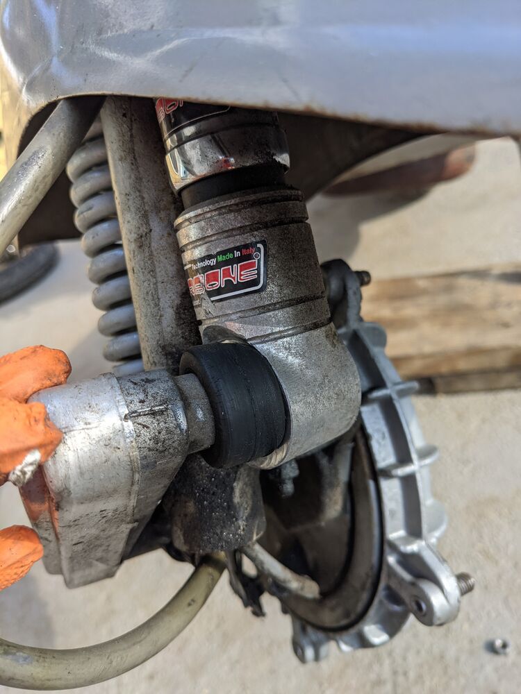

I had a bad Carbone experience with the front shock on my Sprint. It almost separated from the mounting bolt at the lower buffer. No bueno!
Now, fairly or not, I'm kind've biased against them.
That looks odd. Doesn't a nut and washer hold it all together? What's on the other side of that?

You're correct, there was a nut and washer, but the washer is smaller diameter than the buffer mounting hole, so it didn't matter. No such problems with many more and harder miles on the BGM's (or Bitubo's or stock LML, even).

That makes sense, in the way I mean that its failure is from its poor design. The nut and washer hold the bushing on but not the shock. That's brilliant.😵‍💫
