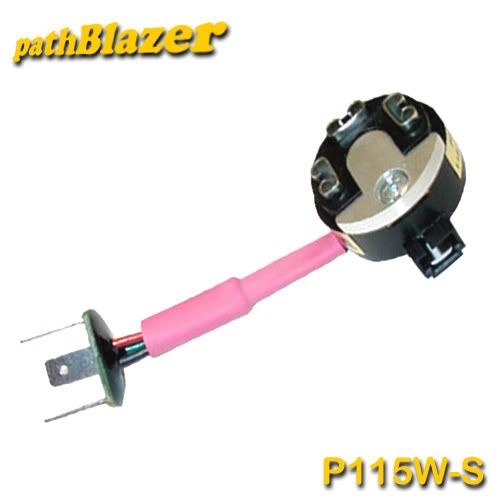

It seems "addicted" installed one and it worked well, but he did not recommend it because of clearance issues. The Kisan is a cool self-contained unit that plugs onto your bulb, and your stock plug then plugs into the Kisan -- a stacked arrangement. He found there was not enough room for the stack, so he had to disassemble the stock plug and bend the leads to make room. I went to the Kisan site and found a variation of the unit he used that has a remote plug for the stock leads, keeping the stack height to the stock height. It looks like this:

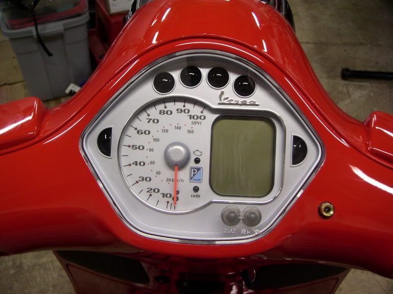

I ordered 2 of these and installed them in both GTSs, and they work great. Truly plug and play with no wires to cut or splice and no clearance issues whatsoever. Next issue was where to put the light sensor. The Kisan sensor requires a fairly large hole (I have to admit the Comagination sensor is very skinny and easy to thread up through the mirror grommet--small consolation if the modulator does not work). Addicted mounted his in his front headset cover behind the headlight. I chose the rear cover next to the instrument cluster so it looks a bit like another button. If you do drill your painted bodywork, be sure to use many bits increasing size one increment at a time until you get to the correct diameter hole. If you use too big a bit, it can grab too much of the nylon-like plastic and chip some paint (don't ask). If I do it again I might actually try a unibit, but that's another thread. I also had to trim down the mounting tabs on the black plastic grommet that slips around the brass sensor body to make it easier to press into the hole I drilled. I used a nice new single edge razor blade. This made more sense to me that drilling an even larger hole. In the photos below, you can see the black grommet around the sensor. The red install was very clean. The blue had an issue with the paint chipping slightly around the hole since I used too big a bit at first, so I slipped a small o-ring on the assembly before pressing it into the new hole and the o-ring protrudes enough to cover my sloppiness.
The Kisan unit with the remote plug is the P115W-S, with the "-S" being the critical distinction between the one I used (that fits easily) and the one addicted used that did not fit so easily. The light sensor is adjustable so you can vary the ambient light point at which time the modulation starts and stops, and the light sensor plugs into the main unit so if your sensor malfunctions (or you mess it up), a new one can be bought for 10 bucks.

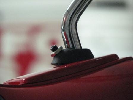

I installed a Diamond Star headlight modulator today.
The light sensor is in the right-side mirror boot. I'm going to spray paint the chrome nut to black so it blends in better.
