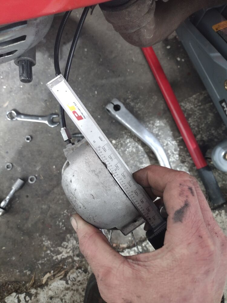

Ray8 wrote:
What you want is an "old PX" selector box.
I'm very happy with two of these. Read the description:
https://www.sip-scootershop.com/en/product/selector-box-kr-automation-px-old-cnc-reinforced_87009200?q=selector%20box
First confirm you have a later box by checking in this manner.

Here's one of my KR's in 3rd:

The selector piece that moves at the end of the shaft is flush on mine in 3rd.
I basically just need to know what selector box to order, which was stated above but it's also 100 bucks. I've seen others for more like 40.
