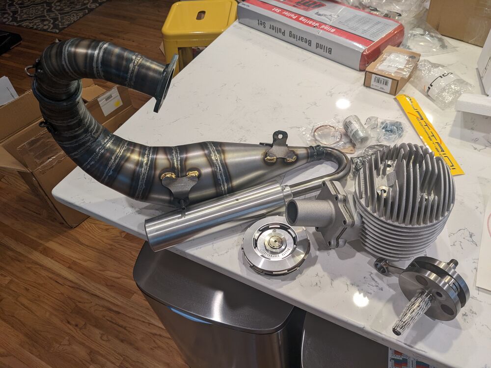

Got a few bits n' bobs from the Go-fast Fairy today, so I guess I should do something with 'em...
Tue, 06 Sep 2022 23:36:08 +0000
Joined: Sat, 22 Oct 2011 16:23:21 +0000
Posts: 5617
Posts: 5617
Tue, 06 Sep 2022 23:36:08 +0000 quote
Sweet Jeebus, that scoot is gonna fly without wings
