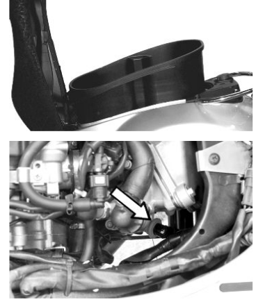

You could check that the spark plug cap hasn't fallen off.

I def didn't hit the kill switch……I have zero idea how to check my spark plug cap.

Now that it has cooled off, follow the plug wire down there until you feel the cap. Check for any loose movement. Then press the cap toward the head with all your strength. Also check the fuel lines, maybe one of them dropped off.

This illustration from the shop manual may help you. Follow tonymarchman's instructions to check the plug cap. As znomit says, the dealer should help you with a brand new scooter, but this is an easy thing you can check yourself. It may be valuable to know in the future, too.
