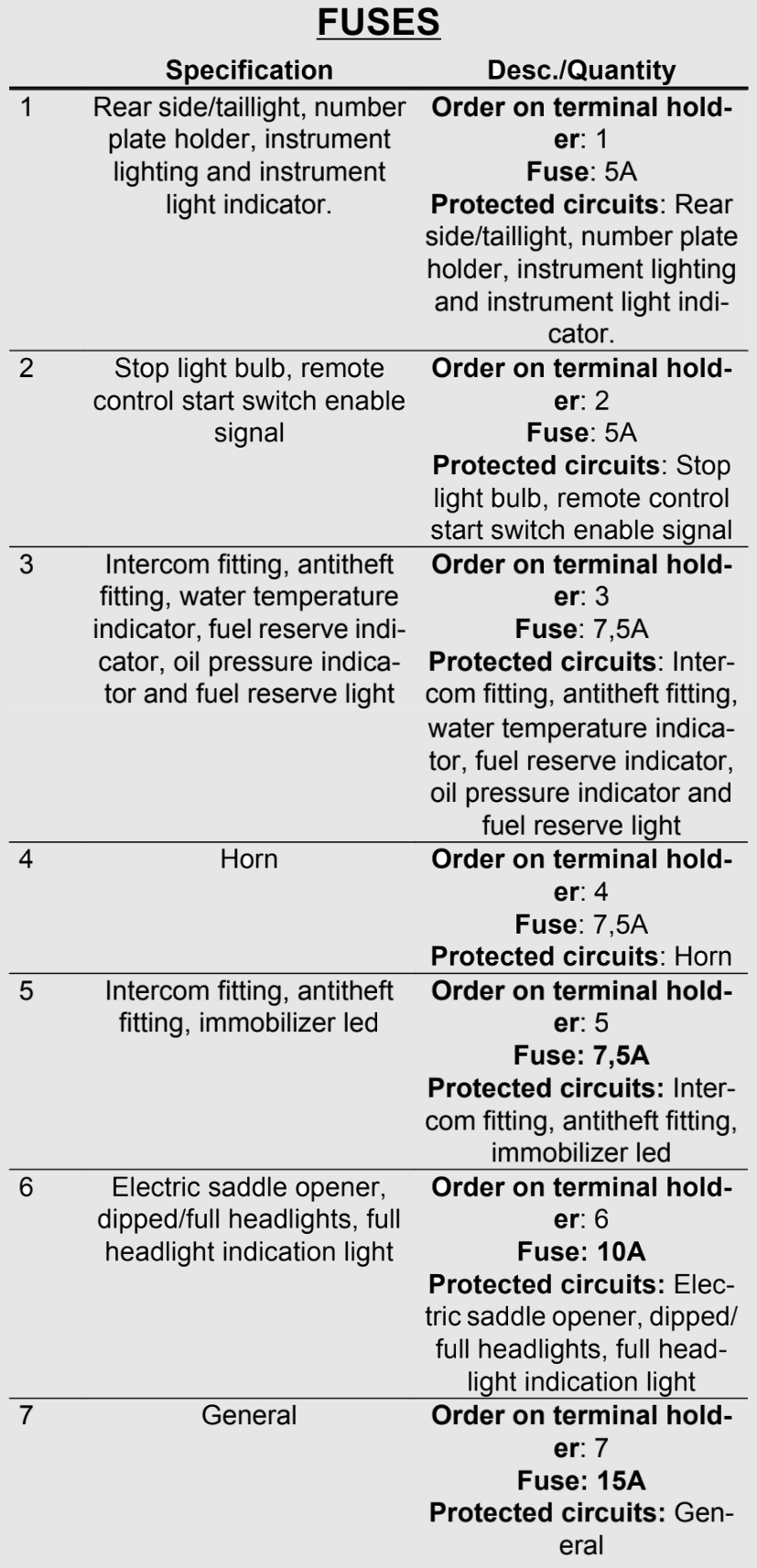

In case it helps anyone who has installed the SIP speedo on the GT200, I had to remove my Fuse #1 in order to have the kill switch work! This is not explained in the SIP install manual. I did this after staring at the circuit diagram just absolutely stumped as to what the cause could be.
Attaching the fuse descriptions (#1 is furthest on the right) as well as a high res version of the wiring diagram I came across before.
Thank you Soooo much for this solution! I couldn't for the life of me figure out what was wrong with the kill switch on my SIP speedometer equipped GT200! Who would have thought 💭 to pull the #1 fuse? I was skeptical that it would work, but lo and behold pulled the fuse… and I have a working kill switch again! Thank You 😊 [/img]
