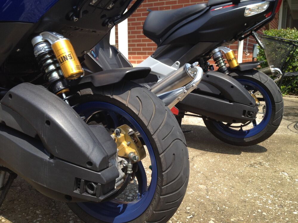

Far out. Wish I hadn't seen this. I had a SR50 w/80 Kit and up gear. Very little torque but a real screamer. It was lite and would haul ass. I had an Ohlins rear shock and front forks sprung and valved by Ohlins. It was a momentum bike, but fun to ride on group rides.
