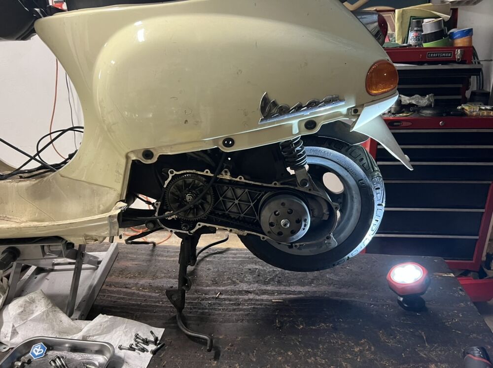

Started Fathers Day off opening up the motor. Was blown away how crusty the belt area was at 1200 km. Take a look at the clutch bell!
Didn't find anything too wild at the piston or cylinder. Stock exhaust was de restricted and the new Wild Lion exhaust has a restrictor installed (WTF)!!
Clutch nut wouldn't come off for the life of me. Cut half of it off and then it came off with my fingers.
Monday I'll swing by Scooterwest and borrow some tools for the contra spring swap/ de restrict the Wild Lion/whatever else.
No head leak. Could still see the exhaust arrow on the piston crown.
I change contra springs on floor of garage. I sit on a stool, press down with both feet and put nut back on. Same process for taking it apart. A clutch tool for a large frame could work also.
As for exhaust is it a washer? If so take a picture, last one I did had one weld, stuck a large screwdriver inside twisted, snapped weld. Then clean up with whatever you have around.

sames, on a 50 just throw your knees on it and bump the nut. install is same. or pinch it up in a vice nice and easy.
on the pipe, just punch that shizz out or use a Dremel/die grinder to get there and then some pliers. blow it out with some air and call it done.
btw, if you're keeping it injection? take a good look at the oil pump belt! quick, cheap and easy to replace now...

I need to buy parts/tires from Scooterwest anyway and they let me use their tools/tire machine. I'll deal with clutch tomorrow when I'm there. Figured i could have them look at it too in case there is wear/replace.
Definitely replacing oil pump belt/ hoses/ drive belt since it's open. While moving it, two stroke oil started pouring out of the cases. Not shitting you, maybe a cup. Now I'm wondering if the cases had flooded from sitting and there was really nothing wrong with the top end??
Exhaust plug was just a washer. Whacked on it for a minute but gave up as we have people coming over soon.

Look for tack weld or maybe welds and punch opposite side, you want it to twist.
@mjrally avatar
Posts: 5360
@mjrally avatar
Posts: 5360
Yep. There's just one weld on it. Stubborn bastard too. Will tackle more tomorrow.

Big thanks to Baumer18 for the explanation of things. Flip choke can get mounted in the belly somewhere with the supplied brackets. Two plastic hollow tubes are for air filter housing modifications on some model scooters (not ET2). Malossi instructions must only be able to be deciphered by Italians and Canadians Razz emoticon.
Malossi instructions say to drill 3 holes in the outer air filter cover of mine if not already done. Mine has the 3 already so good to go.
Rebuilt the clutch using the white Multivar contra spring, yellow plastic torsion controller and yellow clutch springs. Malossi engrish graph on those says it engages at 4-6K rpms. Hopefully that's middle of the road performance for putting around town. Will install with a new clutch bell soon.

Stayed up late and got her going. Flip choke I tucked away right side and somehow managed to lose one of the belt cover bolts. I guess that's better than having leftover hardware?
Installed an 84 main jet. Idles great but take off is too rich. Didn't hold wide open for very long since it's brand new. I definitely want to put a few heat cycles on it before I even try to ride. Not worth seizing the kit.
For some reason the oil pump won't prime. I can reverse fill the oil discharge line and it pumps that into the carb. Nothing comes from the pump though. Oil tank is full and brand new oil line. Not sure if the pumps air bound or maybe it's just slow from the tap? I'll let it sit overnight and see if that helps prime the feed line. Gas tank is all premix for the time being.

Let it idle some more while I was cleaning tools. Oils definitely coming, but coming in spurts. Lots of bubbles in the line and then a solid stream. Rev it up and the bubbles come back.
Bad pump?

Morning restart. Is better, but still introducing air. Definitely leaning towards an oil pump failure causing the original problem. New oil pump is $30.
Compared the clutch engagement to my wife's Buddy and I'm gonna swap to the white springs. This thing needs to be revved up way too high before the wheel turns. Gonna be annoying as a beach scoot if the rear wheel doesn't turn when I twist the throttle.

10 minutes later. Still introducing air
