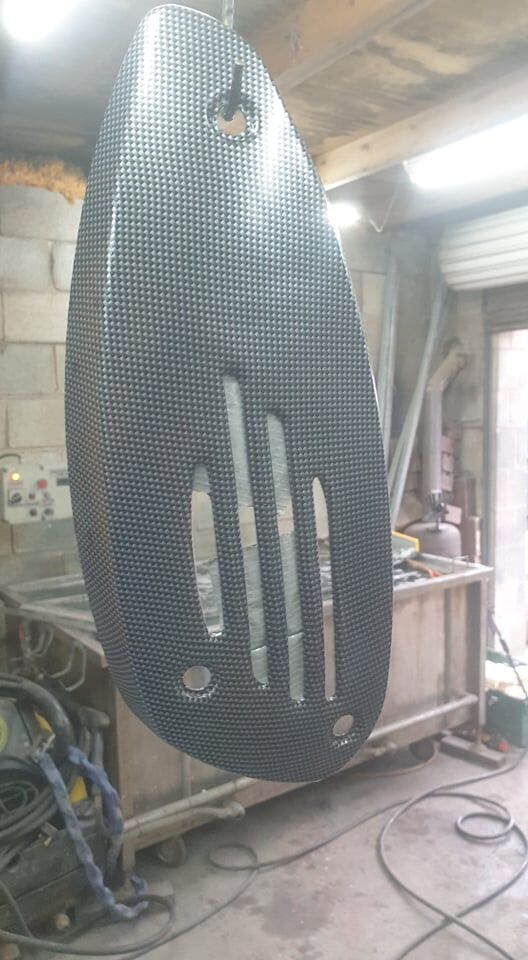

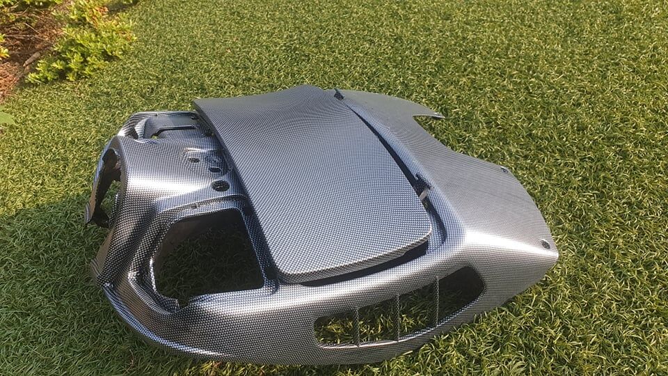

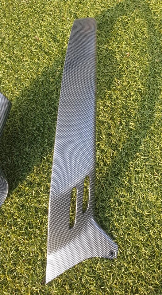

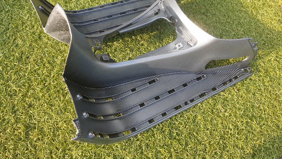

I purchased a gts 300 last year with the intention of repairing the head gasket and moving it on, my mate who is a hydro dipper decided he wanted to hydro dip it in carbon, after welding all the seems up and rust treatment etch and filler primer we are prepping for paint and hydro dip,Will post pics as we go, here are a few pics of some parts already done.

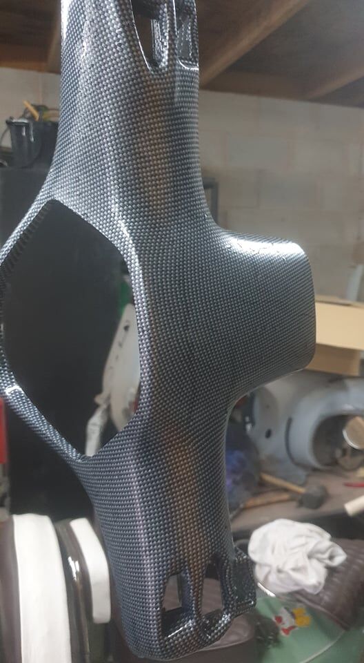

Headset top

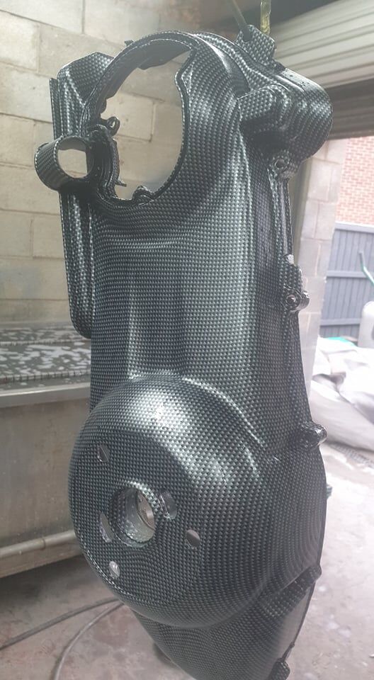

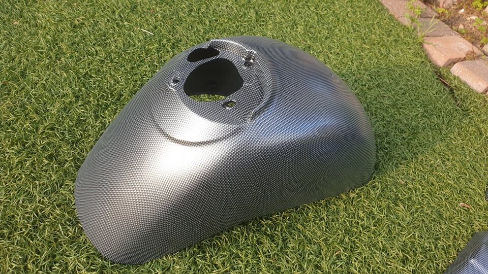

trans case

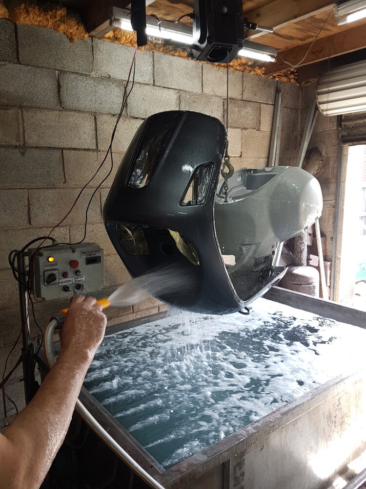

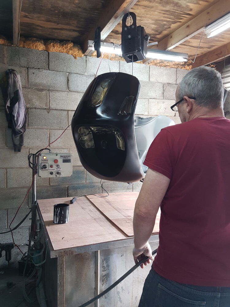

We are going to do the frame in 3 parts so as not to stretch the film.!st dip was front end.
The scooter is rust treated then etch primed, then 2 coats of filler primer, next process is the back paint, and when it is touch dry it goes into the tank. the film is layed on top of the water to soften for around 2 mins, then an activator is sprayed onto the film so it expands, the scooter frame is then lowered carefully into the water and the film transfers on to the fresh paint. sound complicated but pretty simple really, the skill is in how its lowered so as not to cause ripples, which moves the film.

Spraying the black pain prior to dipping.
