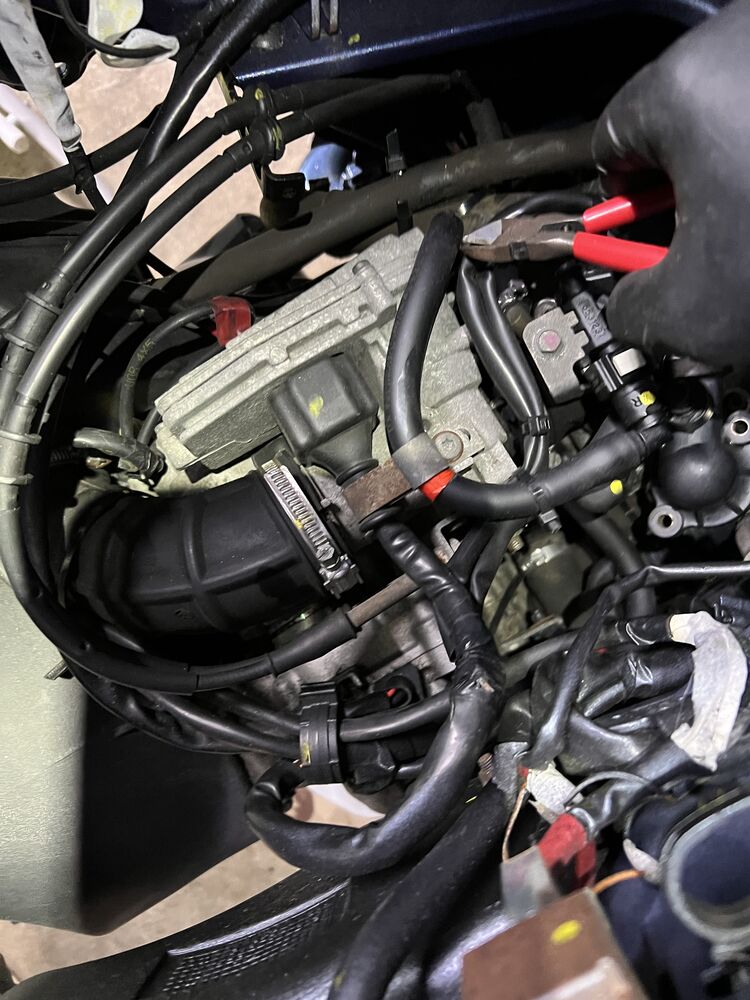

I started to take the engine apart. Drained the cooling fluid. took off zip ties. took off thermostat. next is wheel so that I can take off the back brake caliper. Then oil drain. Air box to get to get to the rear shocks. I hope that I can put it all back together!

I can't believe but I actually detached the engine! I don't know if I will be able to put back together, but I am going to open it up and see what is causing the leak!!

rdhood wrote:
As I wrote earlier:
So, been there done that. You should get 4 new cylinder head studs and try again. Things like base gasket and head gasket are single torque items, so you should also replace those again too, even though they are brand new.
thanks for the tip! tell me how do you screw the stud and unscrew it? with pliers or is there a special tool?
Use two nuts on the top of the stud - bind them together using two wrenches then use your torque wrench on the upper one to wind the stud into place. Then unbind the nuts.
It's not a bad idea to use a trace of blue Loctite on the bottom threads.
I used vice grips to get them out, cleaned the holes/threads, then used back-to-back nuts to get them in and tightened
